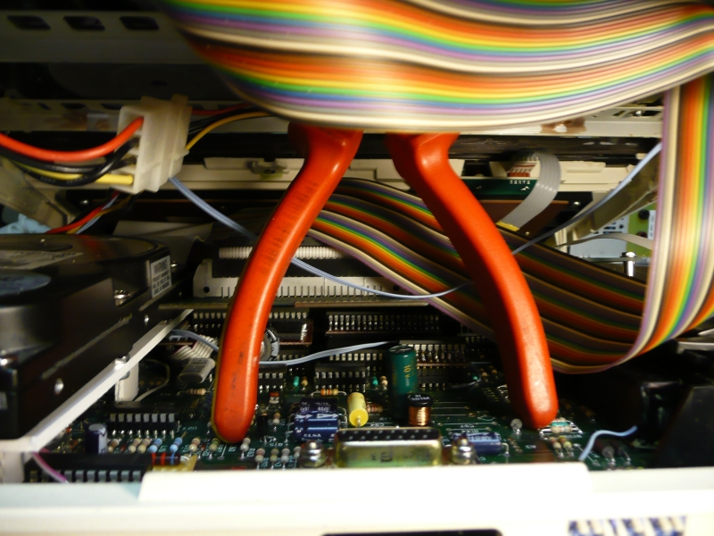

Posted Image
SCSI harddrive in place and 5V powersupply mounted underneath.

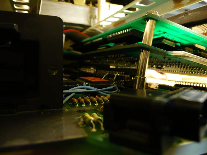

Posted Image
As the Blackbox is a large beast, it gets a bit stuffed under the hood.
Of course i tried and measured a lot before deciding everythings place.
Posted Image
If you lift up the hood at the 1250XLDs back, your this view.
Posted Image
Thats what the assembled machine looks with its 'new' 3,5 1.44M and 5,25 360k drives.
Left of the 3.5 drive is the button for BlackBox Menu.
Perhaps this makes the one or other atarian try the 1200XL pbi mod themselves
or fix the one they did in the past.
Greetings,
Beetle
