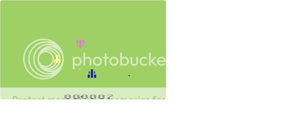

Posted Image
Here's my next project that I'm working on... What started out as merely a demo showing off a car physics engine, has actually turned into a full-fledged game. You basically control a car that zooms around the screen, and the objective is to destroy the opponent cars. As you progress through the game, the enemies get more difficult to shoot at, and there are pickups scattered throughout the screen that will change your weapon.
This is actually my first shot at making physics in Visual BB. I made it so that when you press the joystick in a direction, the car will gradually speed up, and you can actually swerve around corners. It's also my first game that has animated explosion sprites.
Updates 3/11
Alright, so I've got everything in the game fully done as far as the game itself goes.
Now is the tricky/fun part: optimizing the code. I've done a lot tonight with optimizing the code.
After going through the entire game and re-arranging portions of the code, I'm amazed to say that the game runs at 262 scanlines with two active cars on the screen. No changes in gameplay had to be done! ^^
When there are 3 cars on the screen, the game runs up to about 274 scanlines, which is way better than the 282 I had it using up before!
Hopefully at this point the game will not roll as much as it did before on the real system.
So, here's to hoping I can get it nice and smooth-running, but 262 scanlines is 16 less than where I am right now, and that seems to be a looong way down. xDD!!!
Here are some of the features I've got in the game:
- Changing backgrounds
- AI difficulty increases as you progress through the game
- 1P and 2P modes
- Changing the left difficulty switch alters the max. speed of the cars.
- During a 2P mode game, the right difficulty switch enables a battle consisting of both players along with an AI car.
- Working game over screen
- High quality title screen (no music as of now)
- Different weapon varieties -- remote mines, homing missiles and fire missiles
- Realistic car physics
- Pressing the reset button during a game will bring you back to the titlescreen
- Two separate score displays for both players during a 2P game
- Awesome explosion effects
Hope you guys like it! ^^

Looks good! :thumbsup:
A few things you probably already know about:
  • if the car is full throttle and you press the opposite joystick direction the car keeps going in the same direction.
  • occasionally the car gets stuck on the left side of the screen when travelling left.

Nifty! I actually had a similar idea, except the goal was to smash a large truck into smaller cars a la destruction derby. This could turn into a really cool game!
A couple thoughts:
- Is diagonal movement a possibility?
- Full speed seems to be awful fast. I assume though that it wouldn't be difficult to tune it to a particular game's needs.
All in all though, pretty cool demo!

Alright, got a new version of the Car Physics engine up. I completely re-wrote the way the physics were calculated and was able to spare one variable. Considering I was hoping to get 3 cars in the game simultaneously, that's 3 variables which I've freed up for use.
The physics are slightly different too. I think they're a bit better now, actually. The car doesn't move awkwardly fast (but if you prefer the fast speed, you can always turn it on via the left difficulty switch ^^), the car will no longer get stuck when you drive off the screen towards the left, and if you're moving in a certain direction and press the opposite arrow key, the car will slow down and begin moving in the other direction as it should. Also, de-acceleration is much better now. If you're at full speed and let go of the joystick completely, the amount of time it takes for the car to coast to a stop is longer than the time it takes to accelerate full speed. It works quite nicely now.
Hope you guys like it. :3
