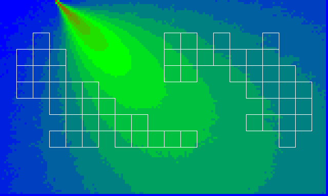

I wrote up a quick and dirty C program to simulate many millions of tics of weather movement across the Utopia map, to see if there are any biases inherent in the weather algorithm. It turns out there are. The weather turns out to be very sensitive to its initial velocity, in fact.
The weather movement algorithm is pretty simple. Weather always originates from [27, 0], with a velocity of [+5/8, +4/8]. (+5/8 means it takes 8 tics to move 5 pixels.) On any given tic, there's a 1-in-10 chance of modifying the weather's velocity. If the algorithm decides to adjust the weather velocity, it picks a direction (N/S/E/W) and increments the velocity by 1/8 in that direction. If the weather moves off screen, it gets deactivated.
It turns out that the fixed starting location/velocity and the deactivate-on-exit behavior lead to a pretty stable distribution of "likely weather" areas. Furthermore, the right island seems to get more weather than the left island, on average, if my simulation is accurate.
Below is my "heat map". Every four bands in the color spectrum represent a factor of 10 difference in likelihood that pixel seeing weather. Two adjacent bands in the color map are approx a factor of 1.78 apart.
Posted Image
As you can see, the right island gets more rain on average than the left, with the buld of the benefit concentrated in the northwest corner of the island. The entire west coast of the right-hand island gets a pretty good bit of rain. The left island has a more concentrated set of raininess along its east coast. Overall, it's dryer.
I suspect this ends up making the right hand island easier to get started with, while both islands are agrarian and just getting established. In the long run, though, since all weather follows these trajectories (rain, tropical storms and hurricanes), the right island will also see more damaging weather events.

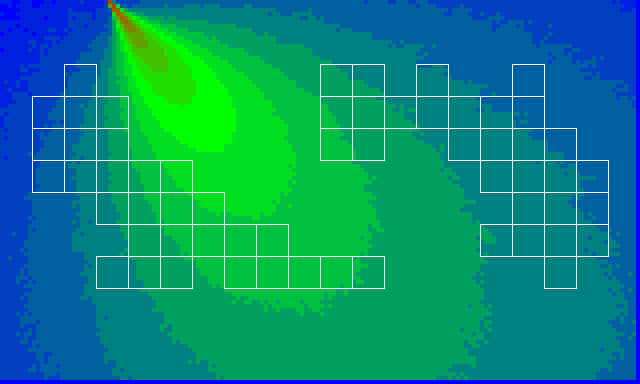

Now, I did experiment with the parameters a little bit, to see how sensitive the model is to that initial velocity. It turns out it's quite sensitive. Here's what it looks like with [+5/8, +5/8] as the initial velocity:

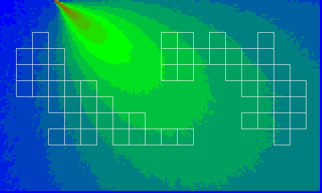

And here's what it looks like with [+4/8, +5/8]:
Posted Image
As you can see, slight changes in that initial velocity really shift the distribution around, even though most of the motion is a random walk. You have an extreme sensitivity to initial conditions, and I think it's reinforced by the fact weather deactivates when it reaches a screen boundary, so you can't average behavior over an unbounded amount of time.

Fascinating. I've always wondered just what the probabilities of getting rain on a particular tile were. I always played with the left island with my cousin, and knew that the bottom right corner of the island got more rain. I figured though that the program was symmetrical and the islands were programmed to have essentially equivalent squares.
So which of the above simulations is the from the game?
And did they make a mistake in the code then? Did they originally intend to mix it up a bit?
I think that was the intention, but the problem is that that goal is nearly impossible with this algorithm within the constraints of the 20x10 playfield. You'd need weather to come in from more angles and a wider range of velocities to even out the map, I think.
The first simulation is from the game. The other two are to show how sensitive the distribution is to very minor changes in the input.
I think they may have. The code I spotted could be in error, or it may be dead code left over from some experiments trying to change things up that never got removed. There's a bunch of weird fossils in the code, such as this inexplictably complex bit of code for making a constant:

I could have sworn that the bottom right corner of the left island got the most rain.
It looked to me that way too, although I must say that there were some rain clouds that seemed to want to oscillate for a long time in the top-left peninsula of the Eastern Island.
Well, they're within 60% to 80% of each other, so it's not a huge difference.
