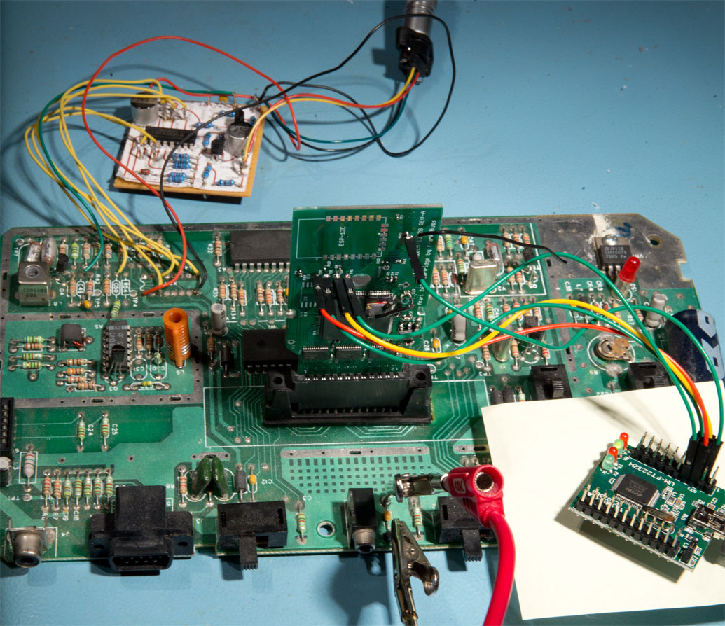

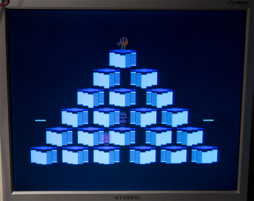

gartenzwerg Posted January 16, 2016 Author Share Posted January 16, 2016 The PCB arrived. First I soldered the 3.3 V voltage regulator, the three voltage level translators and the FPGA, then I wrote a simple VHDL test program which just emulates a 4k ROM, and converted an Atari 2600 ROM to a Lattice memory initialization file (the FPGA is big enough to include the ROM data) with a Python script. I programmed the FPGA with a FT2232H dev kit, which is supported out of the box by the Lattice Diamond programmer. Was a bit tricky to config the FT2232 EEPROM. First I had to change it from "Virtual COM Port" to "D2XX" with the FT_PROG tool from FTDI. Then I had to change the IO pin drive setting from 4 mA to 16 mA because with 4 mA the clock signal looked more like a sine wave on my oscilloscope instead of a square because of the long jumper wires, which caused lots of JTAG programming errors, and I enabled the Schmitt trigger for the inputs. But now it works . Game screenshot from my LCD display: This is the test setup: Bottom right is the FT2232H dev board, top left a homebrew S-video converter (I should really mount this somewhere on the mainboard someday). Now I'm waiting for the WiFi module, shipping needs up to a month when I buy something from China on eBay. But meanwhile I have a nice test setup to implement all the different RAM extensions. The FPGA has a few kB internal RAM, but I'll try to use the external 128 kB RAM on my board. Much more fun to have some more RAM, which is required anyway to implement a web browser. Development turnaround time is fast, too: Synthesizing the current design needs about 10 seconds and flashing to the FPGA 24 seconds. And it can be done in-circuit, just with a mouse click (but needs power cycling after programming). 2 Quote Link to comment Share on other sites More sharing options...
