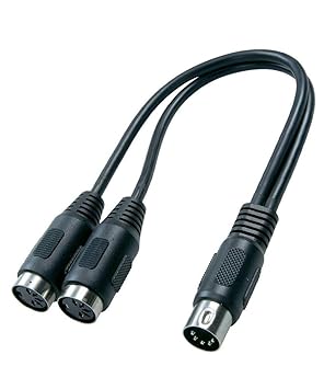

There is another alternative to power, it's not as neat or tidy, but it would be functional.
Something like this could be made up....
One side would be power only, the other side would be normal audio & video or in the case of F18A users just audio.
Or a variation could replace the one pictured above and the other side could have a power connector for the new device.
It's not as elegant as coming directly out of the side port, but it would be able to serve the widest audience.
