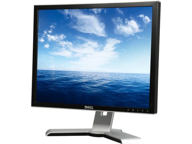

I have a DELL 2007FPB monitor hooked up to a Sophia RevC DVI board (no it doesn't look like the picture below, but wouldn't that be nice ;) ).
Here you go  :) ,
This is being driven by a 1088XEL setup as a PAL system. It looks fantastic, but I have noticed some glitching when running the Near Demo (attached). So far it is the only one that appears to have a problem, but I have a lot more stuff to look at. Also be nice if the over scan area was eliminated, but I'm not sure if that's even possible. Picture sure looks pretty. Great job Simius  :thumbsup: .
- Michael
