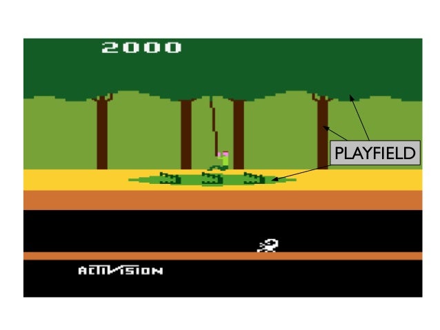

I have looked through the manual and this forum for the answer to these questions (so humble apologies if this has already been answered before - and I missed it).
1) I'm looking have a game that scrolls horizontally using pfscroll. I have got this working, but I can only scroll one playfield, where I need to be able to scroll through 4 playfields continuous before it loops. Is this something Batari is capable of. And if so, how?
2) I have seen advanced looking backgrounds/playfields in games like double dragon, kung fu master, pitfall 2, Cabbage Patch Kids (unreleased game - AWESOME!!). I can do multi-coloured playfields, but how do you do things like add trees with out using sprites?
Any advice would be great.

boski - I have seen that style of playfield before. I think that could work. In fact using that style would allow me to be more creative with my backgrounds, if I play it smart with the colours per row. For example:-
Scramble_Atari_2600_retro_retrogaming-1.
But I would really like some thing like this (the trees add so much to the the look of the game):-
atari-2600-vcs-programming-34-638.jpg?cb
