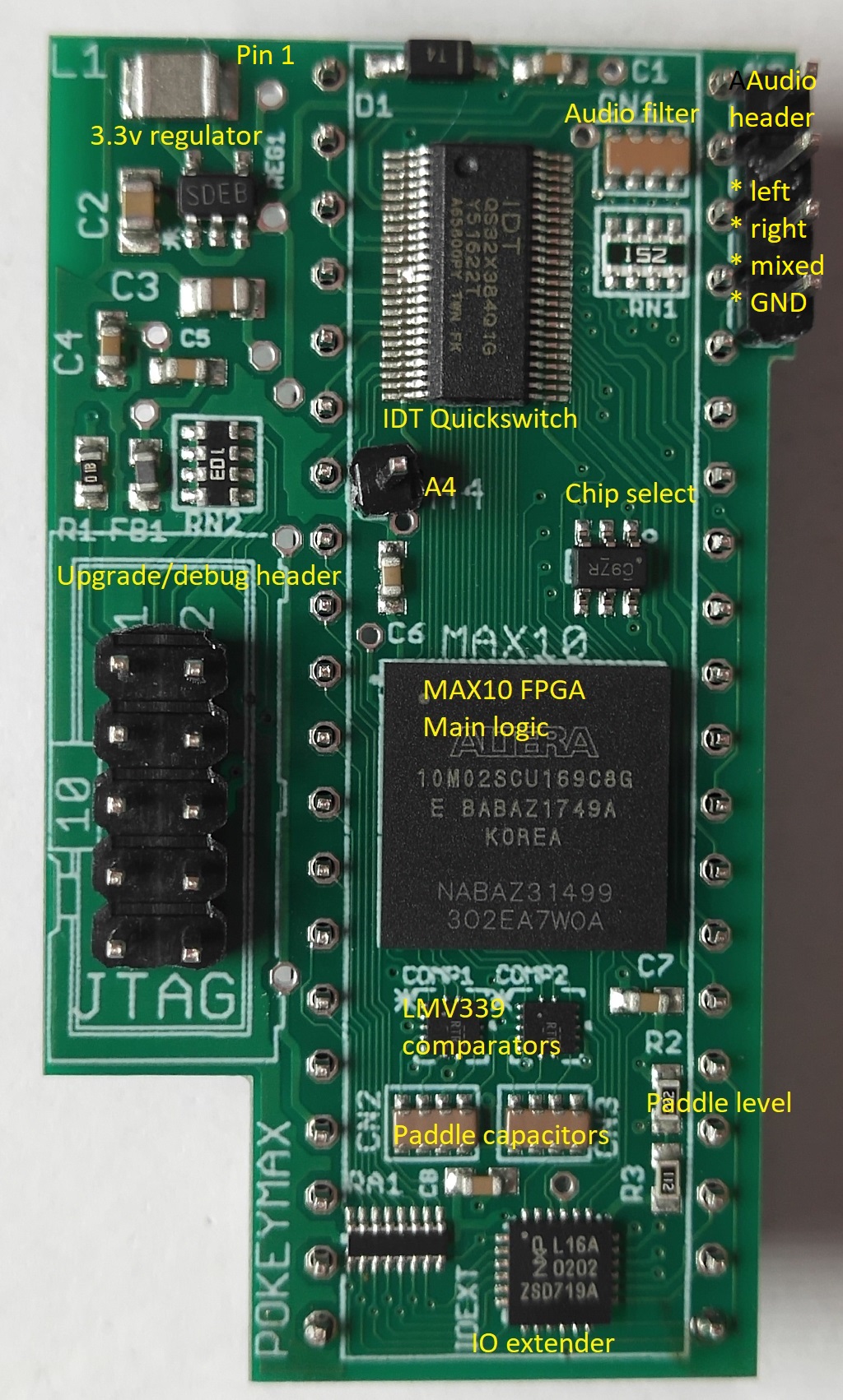

I've been meaning to start a topic about my abbuc hardware competition entry, a replacement for the Pokey chip. It's been mentioned in a couple of threads but I thought many people may have overlooked it.
I tried to be sensitive to cost in my design, though once the full details are released (after competition result) it will be fun here to brainstorm ideas to make it even cheaper! Clearly there are still plenty of real pokey chips, however the supply is starting to become more limited and prices are on the increase.
PokeyMAX
Introduction
The PokeyMAX is a complete replacement for the Pokey chip. It is derived from the work on the EclaireXL project, a complete FPGA based Atari 800XL clone. The intention is to build replacements for all of the Atari custom chips using this technology and Pokey has been built first. It can be used either to replace a broken/missing pokey, as a stereo upgrade, or just for fun!
If pokey is socketed, zero wire installation (mono)
Dual pokey mode
Pins for 3 audio outputs (left channel/right channel/mixed)
Small footprint, only a few mm larger than original IC
Supports all features: 8x paddle inputs, IRQ, serial I/O, audio output, two tone mode, high pass filter and keyboard scan
High level of compatibility
Digital logic
The PokeyMAX is built around the Altera MAX10 FPGA. This was chosen due to its integrated flash memory, power conversion, small size and low cost. The contained logic itself is described in VHDL and Verilog and then synthesized using the Quartus II software.
Level conversion
Most modern FPGAs no longer support 5V logic. While it is possible to find a few they are a vanishing breed. The MAX10 only supports up to 3.3V logic, so an IDT quickswitch level converter IC is used to connect to the high speed lines (A/D/IRQ/serial io etc) safely.
Chip select
Unfortunately I needed more level conversion lines than provided. TI came to the rescue with some 5V tolerant multi-function logic chips with which I was able to combined CS/!CS into one.
Power
The MAX10 requires a single 3.3V power supply, it then internally generates the rest of its supplies. This is very convenient, since often FPGAs require 3 or more different voltage levels. There is a switch mode regulator (LM3670) to convert from 5V to 3.3v in an efficient fashion.
Paddles
These are handled by charging a capacitor that we then check the level of using an LMV339. This is similar to the well-known LM339 comparator, except much smaller! The comparator is used since the level can be set very precisely rather than relying on when the FPGA detects a logic high. The level itself is set to 2.2v using the voltage divider on the right. It is also convenient since its open drain output means there are no level conversion issues. For the drain transistors, a 5V tolerant IO extender chip is used. The FPGA communicates
with this over an I2C bus.
Keyboard scan
An IO extender chip drives the 6 keyboard lines and then reads the response. This is convenient since it only requires an I2C bus to the FPGA and the IC is much smaller than the level converters.
JTAG
The core may be upgraded or debugged using an Altera USB blaster connected here. Several of the JTAG pins are dual use and can be used as general IO. So we could for instance in future plug in i2c devices here or use for A5 (with external level converter) to allow quad pokey or sid etc.
Audio filter
The audio output uses a delta sigma dac. An RC circuit is used as a simple audio filter to smooth the output from this. There are four audio outputs, which are currently fed to pin 37 and 3 header pins (left/right and mixed). Note that the next stage much not draw a lot of current from the rc filter or it will cause distortion.
A4
Pokey has 4 address pins (A0-A3). To make space for a 2nd pokey another address line is needed. For stereo connect to A4.
Errata: Note that the "paddle capacitors" should not be populated and RA1 should be 0 ohm since these are already on the main board, this was a schematic error.

The current bom is about 18usd for components + 2 layer pcb with 5/5 mil spacing + assembly. It uses small parts so I am not sure if it could be assembled at home. I got some spare pcbs to try!
If no keyboard or pots are needed the bottom part of the board would not need populating, saving a few usd.

1) mono version: the price would not change much and the current one works as mono if A4 is simply not connected.
2) Total price: TBD, will depend very much on quantity. The more, the cheaper. These ones cost me about 40usd but it was a small prototype run and I had to make the pcbs twice due to a mistake.
3) Auto right channel=left channel: Very doable, would have to come up with a way of detecting. No writes to pokey2 in 30 seconds and no audio out perhaps?
4) Compatibility: Well even Commodore couldnt make sid match sid exactly! I think its pretty good but it isnt the original chip. Im sure emkay will help me find things to fix:)
5) Stereo switch via Ultimate mb: I guess this is easy, does it output lvttl levels?
6) JHV: No plans but I could be convinced!
7) Video: Ill make one.
