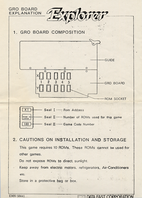

  21. I found some comfirmation in the mame source about explorer. It lists it as missing a rom dump for the add on board. I have no idea what it looks like. Judging by the function I would think it would have to plug into the cpu socket. The one for Treasure Island is called DE-0091xx I would guess that's probably what you need to get explorer working.
    Sorry to bump an old topic, but I was looking through my DECO tapes and I came across this in my Explorer box:
    Expansion Board
    It looks like a diagram for an expansion board. Maybe the MAME team can use this to figure out how it works? It might also explain what that mysterious fourth slot in the DECO cabinet is for. Too bad my system didn't come with one...
    Tempest
    Cool, that may not help the experts but it's helped me figure things out. The rom board plugs into the cage so that the cpu has full access to it from the bus. It's obvious in retrospect. It won't help emulate it w/o the rom images, but at least I know what to look for now. I don't ever remember seeing one on any of the boards I've seen, but then I wasn't looking for one specifically.
