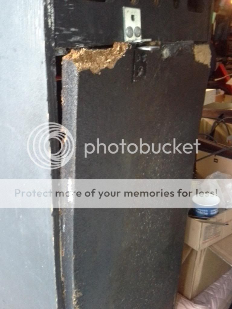

My only question is what condition is the wood in? If the back crumbled that easily, wouldn't the rest be like that?

Most of the wood is rather sound, but what isn't, is bad, and I don't know how I'm going to fix it yet. It was made with two different woods. The back that crumbled off was particle board, which basically absorbed/held moisture like a sponge and self destructed. The rest of the cab is plywood and held up much better on almost the entire cab except the bottom, where so much has eroded away, it doesn't sit even. The floor of the cab is not breached. I think I'm going to flip it over, try to cut off that wood along the green line, and glue on new...almost, "treads", of wood? Just something an inch or two high, the thickness of the original board to run the length of the machine, then sand&paint it to match. (If that description makes sense) The red line is where the bottom of the board should be. The other side in on the ground, this side needs a brick in the back, and a brick and a half to get close to sitting even.

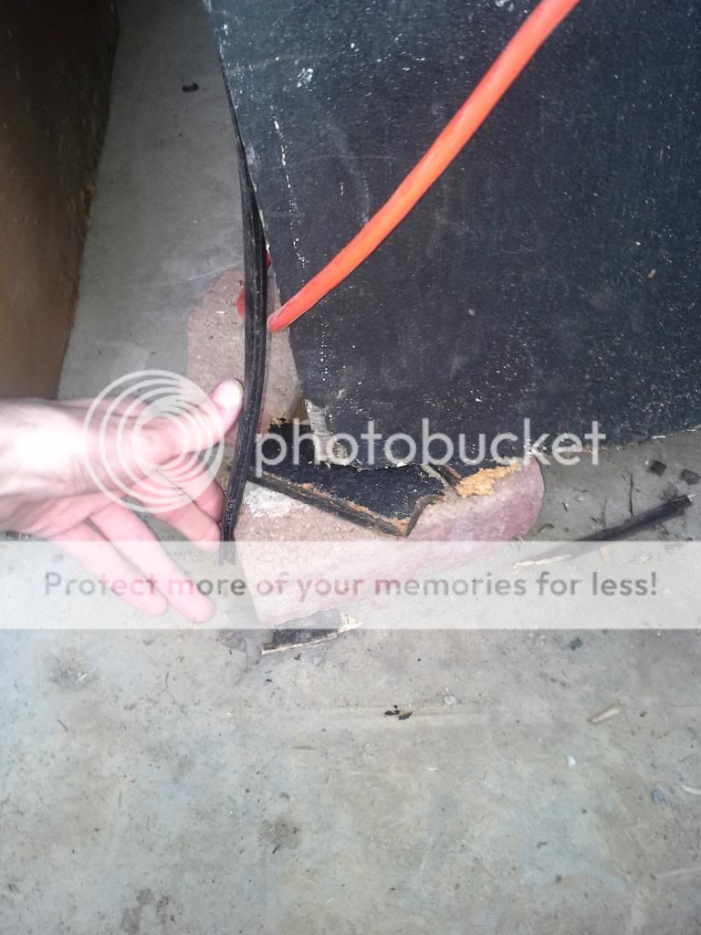

Front The brick, the cab sits lopsided, the frame has some serious damage.
Side Artwork on the side is all gone. I don't see an outline of a decale under the paint, it looks like they sanded it before painting
Day one This is water dripping out of the power switch, the cab looked dry before this and I was about to power it up, I let it sit a while.
Back A little screwdriver work and the back just crubled off....

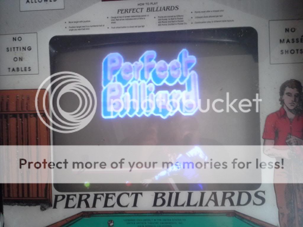

Day three LIFE!

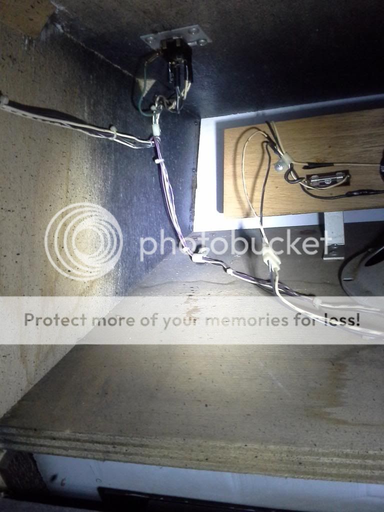

After a few days I got it running! Still no sound, and I don't know why, but I'm working on it. I ditched the original transformer, and am working JUST with the aftermarket PSU. It looks like power originally ran in the transformer then to the supply, but the original trans is dead. Very dead. Jumped it, and put AC right in to the new PSU and life. Right now It's on three independent circuits, one plug for the screen, one for the lights, and one for the system. Eventually I'll unify these circuits. Any advice for sound would be appreciated. Billiards is a pretty boring sport to play virtually, and the midi track would help a bit. I'm assuming it had sound, otherwise...why waste so much effort on the speaker?...which I did test and it works.
The wiring in this is...just....unreal. The original transformer fuses are soldered shut...which may have helped in it's death. The PSU MIGHT have a breaker in it, but I still see no failsafes. The main cable stretch is like a tree. You can count it's age by layers of zipties! Every time it was rebuilt, they ran more wire along side the original, ziptied everything together, then disconnected the original. There's a trunk of almost 30 wires, in three or four layers, and eleven go somewhere, five go to the transformer I disconnected.

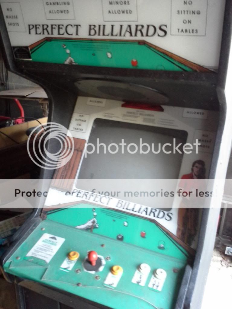

After years of hunting for a maching that the price is right for it's condition, AND is close enough to not cost a ton to move it (as much as I like my car, there is no way my poor little Hyundai is moving a cab) I found one. I paid someone $10 to move it for me, and that's it. I was happy, they were happy they didn't have to pay to get rid of it. The machine is in SAD shape. It's been stored in a carriage house for years, and took on some water damage. The plus side to the water damage, the back was easy to pry off, found just shy of $30 in quarters! The cab gods want this machine to live!
It's currently an off-brand billiards game. There's stickers all over it from small cab maintenance & sale companies. It's changed hands several times, and I think rebuilt each time. After studying it for a few days, I've come to the conclusion it started life as an Atari Berzerk Cabinet.
Since It's been gutted so many times, I think I'm just going to go all-out on a MAME cabinet I don't see ANY potential collectors' value.
After a inspecting wiring (and disconnecting the original transformer which was still getting power for some reason, just not outputting to anything) I gave her some juice! The light came on, but nothing else. I double checked a few failsafe switches, and fed it come currency hoping I could get a noise, and prove the screen dead, but nothing nothing.
It think it's the new power supply. However, I don't have a comparable replacement available. I'm really torn right now. I want to fix it, just for the experience. I'm really uncomfortable working around the CRT, and would rather just gut it, and sell the boards. (Or trade/gift the boards since I can't verify condition)
