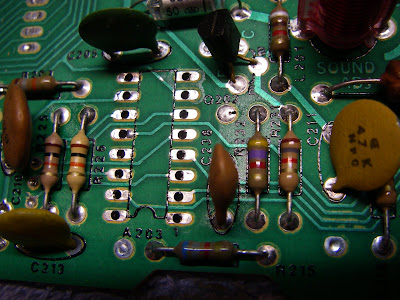

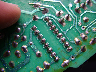

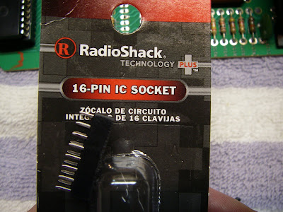

    Here are some images of my standard replacement method for the hex buffer IC.
    And, yes. You could just bypass it with two blobs of solder. If you wanted to. I do custom restorations and offer my customers "refurbished to factory spec - - or better!" quality, so I tend to do things the longer way. :)
    All these images came from a heavy sixer that I refurbed a month or so ago. Got it and a few original CX-10 joysticks in an original 1977 box for . . . very inexpensive. :D But, then I threw $60 of parts and time into it - - switches, new ICs, zener diodes, etc.!
    The unit had a note on it . . .
    Which read . . .
    Hmmm, I know what THAT is! :)
    So, the process - -
    The Radio Shack 16-Pin IC socket
    Clean, de-soldered area after faulty hex buffer has been removed
    Putting in the socket
    Finished soldering in the Radio Shack IC socket - - solder from the back, don't be afraid of using flux!
    Up-close solder job view:
    Socket, ready to receive the new, fresh hex buffer you bought - - you noted which way the old one was positioned before you de-soldered it, didn't you? ;) (look for the "notch" on the IC as a marker!)
    Hope that helps, it's not too hard, and it brings it back up to perfect factory spec!

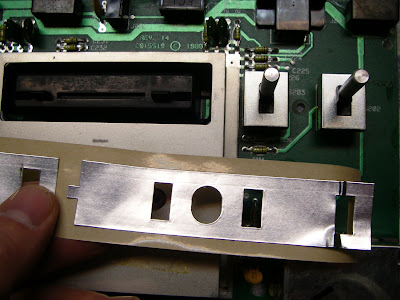

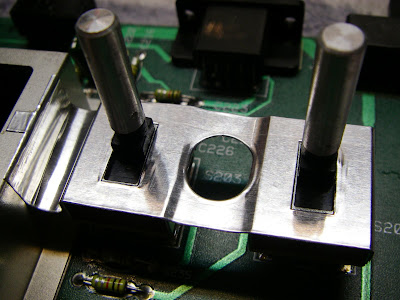

    BONUS PHOTOS:
    Here's a zener diode near the joystick port on a six-switcher after replacement, but before trimming the tails
    And, of course, the static strips (here just being installed on a 4-switch model)!
    HAVE FUN! :D
