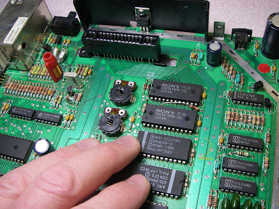

    The Base Unit
    I started with a basic 7800 that had the solder points and hole in the side of the case for the expansion port, but no expansion port . . .
    The European OS mod from BEST ELECTRONICS
    Best Electronics in California sells a "kit" that you can use to modify your 7800 to use the European version of the 7800's operating system
    http://www.best-elec...m/7800.htm#euro
    Highlights and advantages of that mod include - -
    - No logo boot screen; goes right to the inserted game without delay
    - Built-in ASTEROIDS game when there is no cartridge inserted
    It's a relatively complex mod, requiring the removal of the current OS chip, which is soldered directly to the board, replacement with the new European OS, and then a tricky "piggyback" procedure with another integrated circuit where you basically solder a chip provided in the chip onto ANOTHER chip on the board.
    If you are comfortable with soldering, it's all straightforward, just time consuming.
    They even provide nice "extras" like shorter case screws to use when you re-assemble your console, which helps prevent breaking the plastic case - - some older 7800s can have brittle plastic, and if you overtighten, or sink the screw too deep, you can crack the threads or case!
    Here's the instructions that came with the kit, if you want to peruse the step-by-step and see if you want to tackle it!
    BEST ELECTRONICS 7800 Euro OS Mod Installation Instructions.pdf

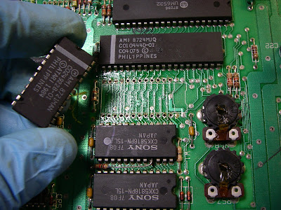

    And, here's the highlight shots of the process - -
    Last glimpse of the original board before it underwent the knife
    Original OS chip desoldered (note that I keep flipping the motherboard around while I work on it, and so you will see the placement of components jump left and right in the pictures!)
    New IC socket in place, and new Euro OS chip inserted
    The "piggyback" IC completed (first picture) and the 30-gauge Kynar wire jumper that goes THROUGH the board and runs to another chip in place (second picture). The NEW socket to the left is for the video mod, which is coming up after this section!

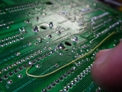

    So, the TIA 9 input is where the blue wire coming off the LOWER LEFT of the board is in this picture - -
    Usually you just wire this point directly to TIA 9, but what you need to do for this mod is put a SPST (single pole, single throw) switch along that line, and flip it to "disconnect" when you are getting your 7800 mode on. Easy!

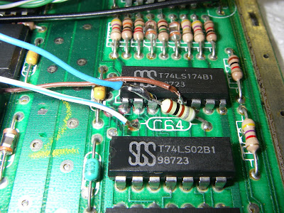

    The simple solution is to disconnect a resistor on the board, and then if you want, put a switch on it . . . so you can restore compatibility for ONE 2600 game . . .
    I know, overkill, right?
    Well, I wasn't using the CHANNEL SELECT switch anymore (yeah, S-Video!) and so I decided to use that as my switch.
    First, disconnecting the single necessary resistor and solder a wire to it (it's the BLUE wire in this picture; the others are for the 7800 video mod and Euro OS mod) - -
    Add some heat shrink tubing for cleanliness and short protection - -

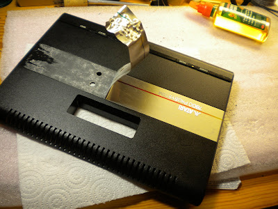

    Finishing Touches
    So, with all that done, we can close up the case and . . . oh, wow, that metal label looks horrible and scratched!
    No worries, BEST ELECTRONICS to the rescue again, with a FRESH old-stock metal label for application!
    First, you of course need to tear it off, and remove the old adhesive - -
    A bit laborious, but the final result looks GREAT!
    I'll take that protective plastic film off the metal label someday . . . maybe . . . :)

    Take apart your sixer and expose the motherboard.
    I used this light sixer, with this serial number, and a manufacturing date of August 14, 1980 - -
    Ugh, this one was kind of gross before it got cleaned, and someone had kludged in a random non-ATARI cable - -
    Here is the motherboard and revision number - -
    And, as shown before, the solder spot - -
    I simply cleaned the solder holes with soldering braid, and then soldered in an integrated circuit socket - -
    IMPORTANT - - note that the socket is BACKWARDS the way I installed it! The "key notch" that shows you which way to orient the integrated circuit when you socket it in is reversed!
    I learned this because on the UNDERSIDE of the motherboard is a VERY small "1" etched into the traces that tells you where the first pin of the integrated circuit should go - -
    Look in the upper left hand corner, near my "1" that is drawn in marker (IGNORE my wire coming off the pin in this picture, it's something I was doing for testing)
    Now, in order to install your ROM, I recommend you actually place it in ANOTHER socket, and you will be socketing THAT socket into the one that is soldered on the board. I do this so I can have some modularity with my ROMs, and swap and try different ones.
    Here's how that looks - -
    I actually place a dot of solder at each of the four corners of the socketed ROM so that it doesn't come back out, too. If you are swapping these things in and out of the motherboard, it can happen, so this just secures it.

    NOTE: desoldering ROMs from cartridges is slow and laborious. Desolder EVERYTHING completely though, and go slow so that you don't hurt the pins on the ROM!
    And, once you have your ROM and have socketed it, then you can place it on the board.
    NOTE the proper direction and orientation of the "key notch" here, which is facing RIGHT! - -
    DO NOT press down all the way with your socketed ROM! Just enough to make contact is for testing is perfect! If you press it in all the way, it's going to be HARD to get it back out without possibly bending pins!
    Once you are certain the project is done, you can "click" it positively in, however.
    And, that's it.

    Now, there was a lot of talk in that thread referenced above about cutting ground traces, adding in a zener diode, and other "pull up circuits."
    I tried all that. I also tried it all WITHOUT it. So far, it works the same EITHER WAY, compatibility bugs and all.
    (note my zener diode and the cut trace on the ground, just like "Longhorn Engineer" had)
    Now I have repaired the cut trace, and removed the zener diode - - and I have the same exact compatibility as I did before. This is how it is operating now.

    I would like to put Yar's Revenge in a six switch.
    Is the only requirement to disable the built-in ROM grounding of cartridge pin 12?
    Does something else have to be added because Yar's is a 4K ROM?
    I look forward to your future projects.
    No, that is not the only requirement, there is additional wiring needed to accommodate a 4k ROM in a Light or Heavy Sixer, but I am still figuring it out, so I could not tell you yet! :)
    It's a project in process, and yes, I will be posting up my results and asking for help with installing games in the Light Sixer "as it was designed" !
    I think I will get some time this weekend to share with everyone where I am at with it . . . but here's some pictures to tantalize you!
    Coming along nicely! This is, of course, building on the work of others - -
