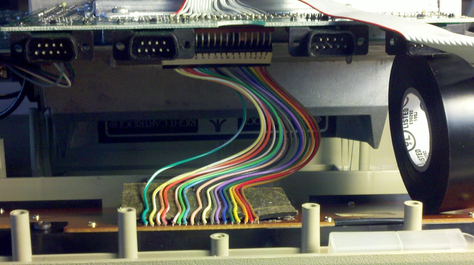

  12. Here is a summary of what I found when fixing the 10 or 11 "broken" (non-working) keys on my Atari 800. Not in any particular order. Hopefully this will help others.
    • The root cause for all broken keys was that the solder pad(s) for those keys had been lifted off the underlying PCB. Appears some kind of force was applied to the key and/or they were mounted in a way that allowed pressure on the keys to push the solder pads away from the PCB. This popped the pads free which in turn broke continuity at just about every pad. Some pads made intermittent contact. The effect was that every pad made a break in the circuit which prevents the key and all others after it from working.
    • The keys themselves were fine. The mechanical mechanisms worked. This was verified by using a multimeter to test each key directly. Probe right at the contact points for that key where it is soldered to the PCB.
    • You may not be able to see the breaks. You will need to use a pencil or test probe to push on each key's solder points. There are 2 leads from each key that will stuck up slightly at the PCB and you can push on the sharp end of the lead to see if it moves. If the key's lead wiggles at all, then your solder pad is loose / broken and you need to jumper it with wire for best fix.
    • The fix was to solder wire from the nearby working neighbor keys (as per the circuit diagram) which thus restored continuity.
    • You will need to carefully remove as much of the foam mess as you can without further damaging the traces. You cannot test continuity across the PCB without removing the foam at least off each solder joint.
    • Check continuity from the connector at the end of the ribbon cable down onto the PCB connection. This rules out the ribbon cable.
    • Use the Atari key scan matrix diagram to figure out which pins on the ribbon cable connect to which keys.
    • The diagram tells you which ribbon cable pin goes to which key, so visually follow the trace from the incoming PCB pad of the ribbon cable up across the board to the first key. Check that path with a meter. Then check from that key to the next (as per diagram and / or the circuit traces themselves).
    • Simply touching up / resoldering each pad will not repair a problem where the pad is actually lifted and disconnected from the traces. You need to add your own wiring to make contact to - and across - the lifted pad so that what was once an isolated key is now part of the chain again.
    • I jumpered across the non-functional pads and soldered at each point, effectively making my own traces to replace the many damaged ones on the board.
    • It is not high-current - I used some spare wire-wrap wire that I had from some long time ago project.
    • After resoldering everything, I used a printout of the scan matrix and checkmarked each and every connection as I retested them with a meter. You want to verify that the incoming ribbon cable pad at the PCB has continuity up through each key that it is supposed to interact with.
    • Reading glasses helped a lot.
    • Like 3

    Interesting result - pushing on U17 made the system work better for a short time. Immediately after pushing on U17 I had 2 successful boots before it failed again. U17 is labeled 1100008-01 which is the GTIA.
    Separate Note - the chip that originally had a bent pin was U22 - C012294-19 which is Pokey. I had found either pin 20 or 21 was bent under the IC and not making contact. I have since straightened it and made sure it is seated OK. That would be /K2 or /K3 as per schematic. That would cause issues with Keyboard scan. This could not have passed initial burn in that way. Must have been replaced by an owner, and done poorly.
    In summary, I should start next with trying to swap these 2:
    U17 - since physical motion affects its behavior.
    U22 - since the prior owner was running it with one pin open-circuit for who knows how long.
    Is there any commonality with the 400? I have a dead 400 I could rob. Looks like I could steal both of them (depending on whether I have a GTIA or CTIA) - A101 / Pokey is on the motherboard, and A301 is the CTIA/GTIA on the CPU board.
