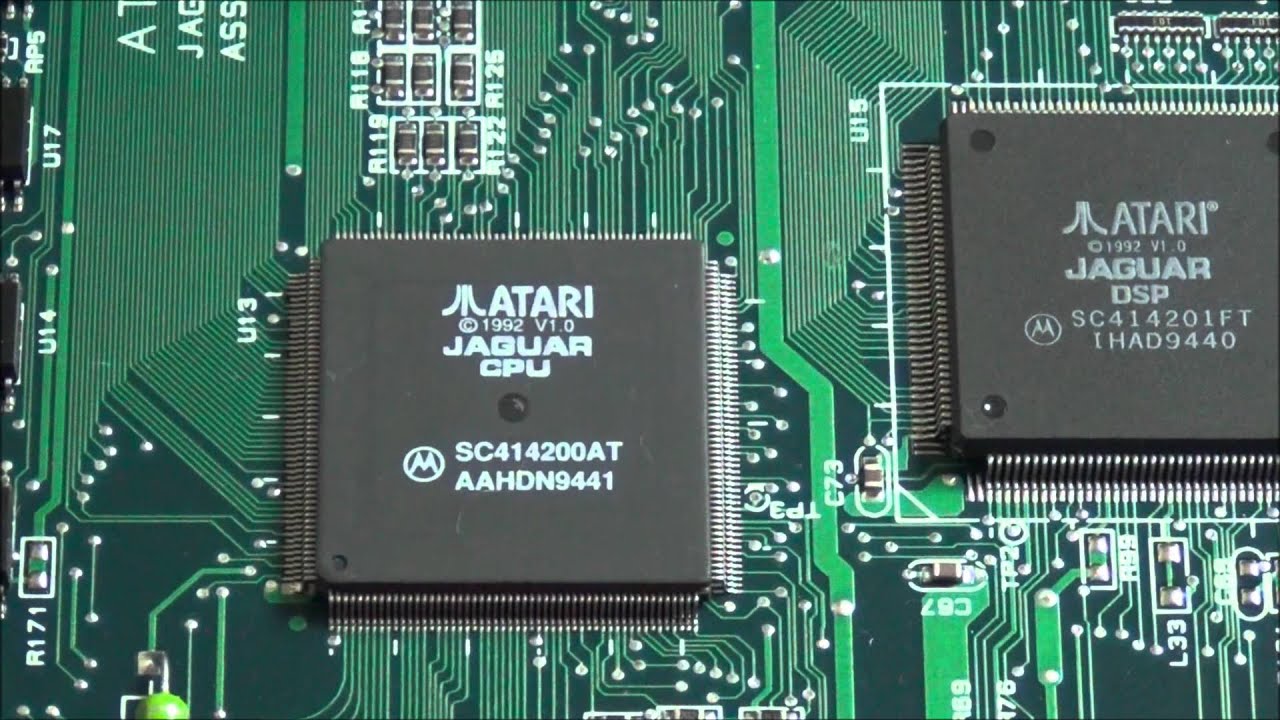

  10. Boy do I feel stupid.  The part number is on Best's website.  It is SC414201FT.   This thread can be deleted, or left as an eternal monument to my shame 😆
    It looks like I will need to cannibalize another non-working jaguar or deal with the audio issues until the console finally dies.
    I guess while this is still up, does anyone happen to have a 6SC600HF106 DSP laying around that they would be willing to sell me?
  11. I am looking to replace what I believe is a failing DSP in my Jaguar.  I have a few games where the audio has issues (Atari Karts & Some of Reboot's Games).  Symptoms are audio doesn't play at all, games crash, or audio runs at a fraction of the speed it should.  I have confirmed that these same games work just fine on two of my other Jags. A few people have suggested that the DSP is failing.  I am open to other ideas other than replacing the DSP if there are other things that I should check/replace before one of the primary processors on the board.
    Best Electronics has replacements, but they can only replace Jags that have the "2nd Generation" DSP.  Is there a sure way to identify whether or not the Jaguar has a 1st or 2nd generation DSP?
    After compiling the list below, it seems that there are only two part numbers for the DSP, SC414201FT and 6SC600HF106.  I am assuming right now that SC414201FT is the 2nd generation DSP since it has a later range of manufacturing dates (9428 to 9506) when compared to 6SC600HF106 (earliest 9336 to 9405).
    Here is the sampling of Jaguar motherboards I used to make this assumption (sorry not very organized, I compiled this as I was writing this post):
    1. CPU V1.0 (SC414200AT, AAHCC9436), DSP V1.0 (SC414201FT, IHAC9441) <-- Link to Image
    2. CPU V1.0 (SC414200AT, AAHDN9441), DSP V1.0 (SC414201FT, IHAD9440) <-- Link to Image
    3. CPU V1.0 (SC414200AT, AAHBQ9428), DSP V1.0 (SC414201FT, IHAB9428) <-- Link to Image
    4. CPU V1.0 (SC414200AT, AAHFL9451), DSP V1.0 (SC414201FT, IHAH9506) <-- Link to Image
    5. CPU V1.0 (6SC880HF106, 9336YAI), DSP V1.0 (6SC600HF106, 9336EAI) <-- Link to Image
    6. CPU V1.0 (6SC880HF106, 9350YAI), DSP V1.0 (6SC600HF106, 9336EAI) <-- Link to Image
    7. CPU v1.0 (SC414200AT, AAHFJ9450), DSP V1.0 (SC414201FT, IHAF9449) <-- Link to Image - CoJag Arcade Board
    8. CPU V1.1 (6SC880HF106, 9417EAI), DSP V1.0 (6SC600HF106, 9405EAI) <-- Link to Image - My Jaguar that is having audio issues.
    9. CPU V1.1 (6SC880HF106, 9408YAI), DSP V1.0 (6SC600HF106, 9405EAI) <-- Link to Image
    10. CPU V1.1 (6SC880HF106, 9417EAI), DSP V1.0 (SC14201FT, IHAE9424) <-- Link to Image
    11. CPU V1.1 (6SC880HF106, 9417EAI), DSP V1.0 (6SC600HF106, 9345EAI) <-- Link to Image
    12. CPU V1.1 (6SC880HF106, 9417EAI), DSP V1.0 (SC414201FT, IHAD9433) <-- Link to Image
    13. More out there...
    I am looking for a second opinion before buying since the costs to get a replacement and then having someone replace it will be considerable (but still less then a new Jag).
    Thanks for the help!
