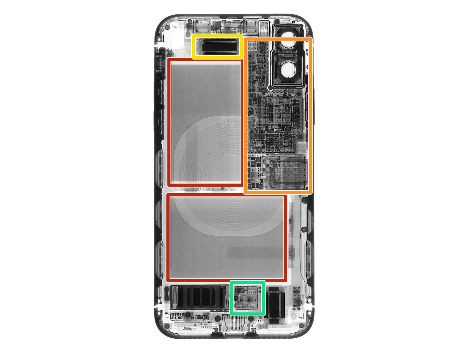

  15. If we could get a high quality xray of a piece of hardware, which one would we benefit from the most?
    Like this xray of the iPhone X here, in Step 3:
    The huge photo:
    I'm not just speculating. The engineer who produced that xray made me this offer.
    I'm thinking, the 4 layer PCB for the Geneve. I don't know if individual chips would be useful.. think of reverse engineering LSI.
    I wonder if the Geneve gate array would reveal useful info?
