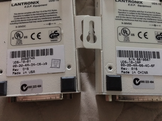

Ever since I changed my Lantronix to auto-increment source ports, I am not getting half-loaded pages anymore. I have had the chat program running all evening in my lab and it has loaded 100% each time - something it wasn't doing at all before. Sadly, I never seem to be on the chat when anyone else is

Stuart:
I checked and I don't have this setting in either of my UDS-10 devices. I've not had the timeout problem, so maybe mine has this set by default and it isn't changeable?
[[email protected] ti994a]$ telnet 192.168.0.242 9999
Trying 192.168.0.242...
Connected to 192.168.0.242.
Escape character is '^]'.
MAGTEK ETHERNET INTERFACE UNIT
Serial Number 2450745 MAC address 00:20:4A:24:C6:39
Software version 04.5bB (010903)
Press Enter to go into Setup Mode
*** basic parameters
Hardware: Ethernet Autodetect
IP addr - 0.0.0.0/DHCP/BOOTP/AutoIP, no gateway set
DHCP device name : not set
***************** Security *****************
SNMP is enabled
SNMP community name: 80
Telnet setup is enabled
TFTP download is disabled
Port 77FEh is enabled
Web Server is enabled
Enhanced password is disabled
***************** Channel 1 *****************
Baudrate 38400, I/F Mode 4C, Flow 00
Port 10001
Remote IP Adr: --- none ---, Port 00000
Connect Mode : D4 Disconn Mode: 00
Flush Mode : 00
****************** Expert ******************
TCP Keepalive : disabled
Change Setup : 0 Server configuration
1 Channel 1 configuration
5 Expert settings
6 Security
7 Factory defaults
8 Exit without save
9 Save and exit Your choice ? 1
Baudrate (38400)
I/F Mode (4C) ?
Flow (00) ?
Port No (10001) ?
ConnectMode (D4) ?
Remote IP Address : (000) .(000) .(000) .(000)
Remote Port (00000) ?
DisConnMode (00) ?
FlushMode (00) ?
DisConnTime ( 00:00) ?:
SendChar 1 (00) ?
SendChar 2 (00) ?
5 Expert settings
6 Security
7 Factory defaults
8 Exit without save

I think maybe you can. They share the same data sheet as far as Mouser is concerned. I would definitely give it a try if you have one around. If you're going to buy one, I know the UDS-10-01 does work for sure. Hopefully others will chime in.
Cschneider - I'm anxious to see if this fixes your issue as well. It sounds like some NAT devices may disallow new connections using the same source port, until that "connection" is timed out. The connection is a state that the NAT maintains for your internal IP address to the outside world, so when it gets responses from the remote end, it knows where to send them internally. Auto-incrementing the source port for each new connection is like how your PC works. I just confirmed this on my MacBook by hitting one of my websites which watching in the terminal and showing my connections.

Here is a picture of mine, on the left is a good one and on the right is the one that will not work:
http://myti99.com/Lantronix_UDS-10.jpg
