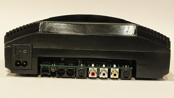

On 7/19/2019 at 1:16 AM, sirlynxalot said:I thought i read something about that this thing was the JAG2 that never got released. By the way the painting looks more then horrible!
And the "bump" to open the case.... . No Way. Looks like someone tried to push the case in with a hot air gun.
EDIT:
if you look carefully then you can see that the bottom tile of the case is much bigger then the normal one. either he build a new bottom case or this one is the JAG 2 Prototype.
