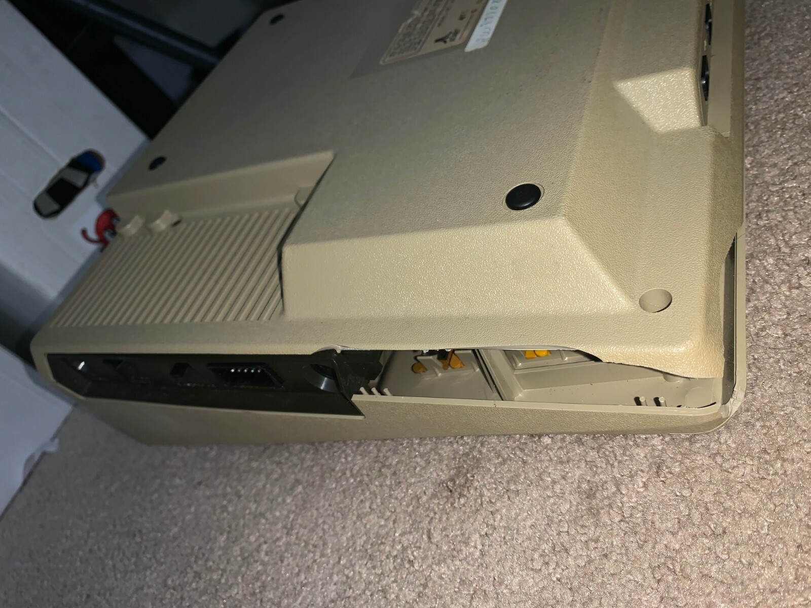

I really enjoyed looking through the "Old pictures of our Atari 8-bit setups" thread, but it made feel a bit sad since I don't think I have a single photo of my beloved Atari 800 from back in the day.
But, at least I can take photos of my "new" Atari 8bit computer setup, and I thought it would be fun to see what other people have and how they've setup everything. So, I'll start it off with my current setup. Both the 800 and 130XE were acquired from Atariage members over the past couple of weeks, and I am thrilled to have Atari computers again after nearly 2 decades. They are both in superb condition and very clean. The monitor is a Sony PVM-2030.
Star Raiders appropriately displayed as a work of art
Lovely 800 with no yellowing (it may look a bit in photos but in real life it's not)
Equally lovely 130XE with fully working keyboard and RAM (so happy!)
Young and old, but both supermodels 🙂
Yeah, I like Repton a lot (plus it helped me diagnose a bad RAM card)
OK, there's mine, now show me yours. I know many of you have amazing Atari 8bit setups, so let's see 'em!
