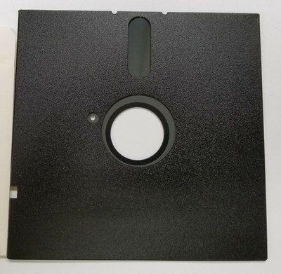

  2. Pretty much.  Hilariously, even a PC's floppy controller can produce a mac formatted floppy. (ARDI Executor, and FUSION PC emulator both had capabilities to do this) This is of course, with the HUUUUUUGE caveat that the PC floppy controller will never, ever, in a million years, be able to read or write GCR., and thus will never be able to make an 800k floppy.
    But still-- To be further educational:  Hard sectoring was a thing that was done with 8in and 5.25" diskettes. On a soft-sectored disk, there is a single hole used to track a full rotation of the disk cookie. On a hard sectored disk, there are multiple such holes.
    These are read using an optical pickup through a tiny punched window in the disk sleeve.
    On a 3.5" diskette, there is no mechanism to track a full revolution of the disk cookie (in the diskette itself). Instead, there is a small magnet affixed to the side of the drive motor that spins the cookie, which is picked up by a coil winding.  When the disk is spun, this is registered by the drive's electronics.
    https://lh3.googleusercontent.com/proxy/rz8_8jBifg9uQKOKxzrHbcwmBUNHrUJzwsGUJONwO5P5uo_WPA3xoprN99y-mw40HT1Q2jfe6Nhh-V2n6KmbdD4kKoB_ZtxTx9KwhxkfFoDK1fFqxdD9RMYHP9Ujwrt-w7mTZLZWMQ
    As such, all 3.5" diskettes are technically 'soft sectored'.
