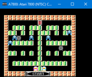

Small update,Got both characters being controlled by the player,vertical and horizontal position adjustment to not get stuck on the tile edges is also now working.Implemented spawning the spiders yesterday,code will check if the row,column is clear to place a spider.Next will be to implement the spider logic.
If you like to follow development you can have a play...http://s000.tinyupload.com/index.php?file_id=91217663233120254088

I was looking at Binary Land for nes and this is the best I can do.

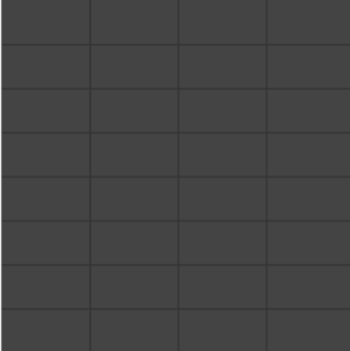

Sorry for another question..but I noticed a member created some bubble bobble game pixel art,those are in 4x8 format & sprites at 4x2.I displayed his tiles in the 4x8 per level so my question is how many sprites at 8x16 is possible?I read that 4x8 tiles will cause the Maria to work more and cause me less objects.Any suggestions
