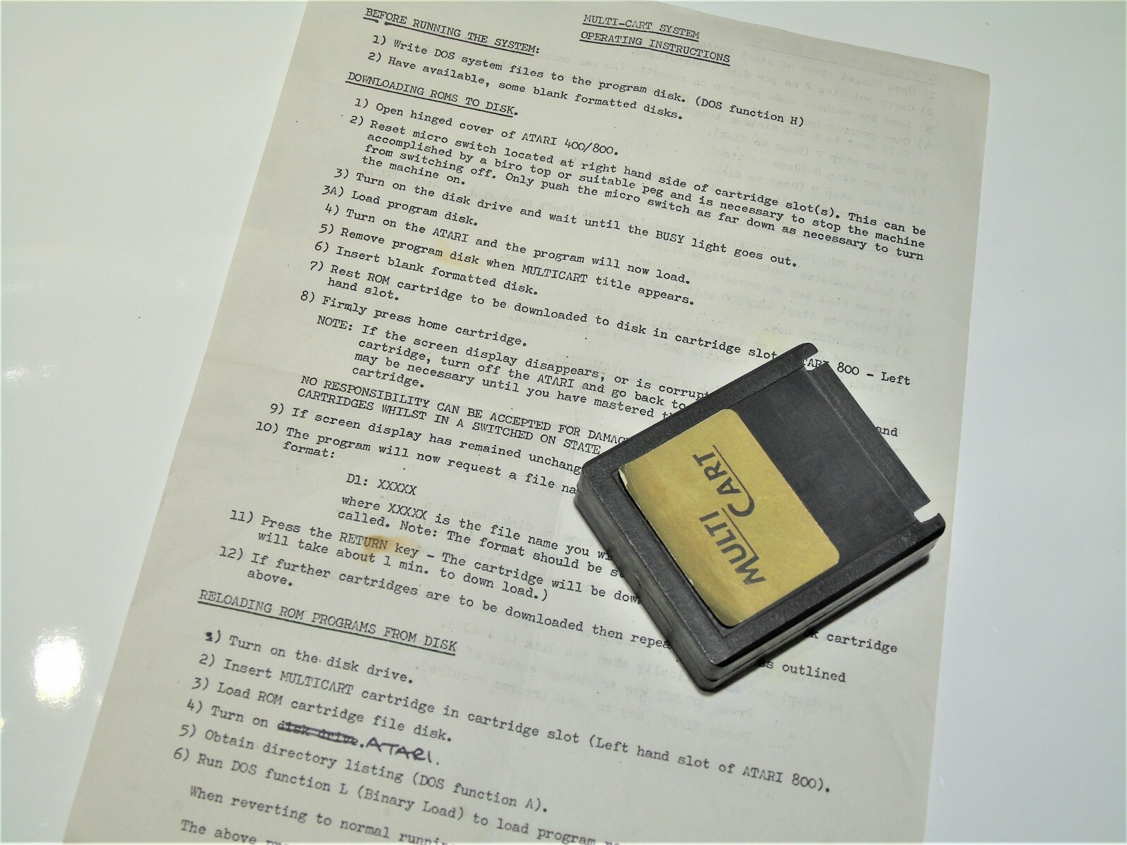

    I recently got my eyes on this interesting ebay item:
    https://www.ebay.com/itm/294157875908
    Image 1 - HOARD! Multi Cart 8 Bit Atari Computer 400 800 1200 Video Game System Complete
    It looks it's an old Atari 800 Multi Cart made in the UK. Unfortunately, the accompanying instructions don't show details on the maker or the year this was released.
    I searched on Atarimania and I was not able to find an entry for this Multi Cart.
    Just for future reference, I have OCRd the accompanying documentation from the ebay photos, here it is for you:

    Do you have any additional information on this Multi Cart?
    Kind regards,
    Luis.
