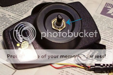

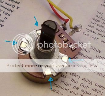

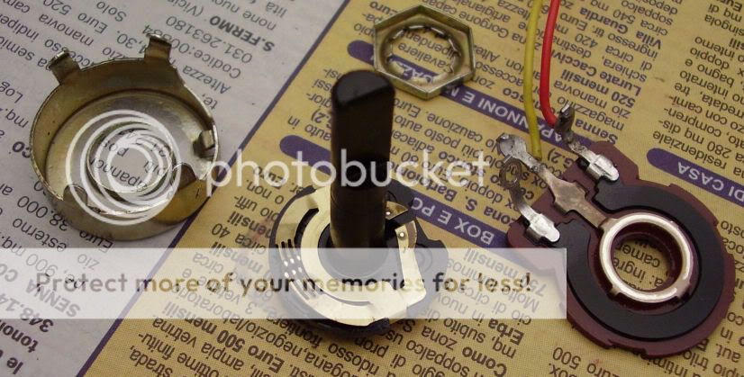

alex_79 #7 Posted April 17, 2007 Some pics which may help you: 1- hex nut under the knob which keep the pot in position 2- metal tabs which you have to bend to open the pot 3- the pot disassembled, before and after cleaning Quote Share this post Link to post Share on other sites
A.J. Franzman #8 Posted April 18, 2007 (edited) Thanks for the photos, alex_79. I notice in your 3rd photo that the pot had some remains of the graphite grease that Atari was so fond of, that seems to be the cause of 90% of the instances of jitter when it dries out, on the wiper and resistance element. Another thing that I thought I'd mention, is the presence of a different grease-like material in the bottom of the metal casing (the piece with the tabs that are straightened to open the pot) and on the bottom of the plastic part of the wiper that fits into that part of the casing. This material is actually not there as a lubricant, but as a high-viscosity substance which intentionally gives the controller a certain amount of smooth stiffness. If this material is removed or contaminated by a different grease or lubricant, the paddle knob will turn much more easily. If you like the original level of stiffness, be careful to NOT remove this grease or get any other lubricant in contact with it. In fact, you could use a small screwdriver, toothpick, etc. to scoop out some of the material that has pushed out from the normal path between the parts and apply it evenly to the raised plastic ring on the bottom of the wiper to help restore the original feel. Edited April 18, 2007 by A.J. Franzman Quote Share this post Link to post Share on other sites

alex_79 #12 Posted April 18, 2007 I tried to spray the cleaner inside the pot without disassembly it, but the result didn't satisfy me. The jittery was reduced but not completely gone and after a few days a new cleaning was needed. I then tried the disassembly method and that solved the problem definitely. After about six months the paddles are still smooth and completely jitter-free. I think "Circus Atari" is a good choice to test them: you can move the player with 1-pixel precision and you can notice also the slightest jittery. I also have "Breakout" but It seems to be less sensitive (probably the paddle input is checked less frequently in the code) and therefore I think is not suited for that purpose. I read somewhere that also "Video Olimpics" is a good test for paddles, but I don't have that game. Quote Share this post Link to post Share on other sites

Video #19 Posted April 20, 2007 Some pics which may help you: 1- hex nut under the knob which keep the pot in position 2- metal tabs which you have to bend to open the pot 3- the pot disassembled, before and after cleaning That's gotta be the most useful set of pics I've ever seen, most people don't describ how to actually take the damn pot apart, and just suggest dunking it in Alchohol to get it good and drunk and it'll be nice and loos for you....er...I mean twisting it till the black gunk comes out. Thanks for that. Quote Share this post Link to post Share on other sites
A.J. Franzman #20 Posted April 20, 2007 (edited) Here's a note for the less mechanically adept: When re-installing the pot into the case top, do not allow the pot to rotate and press against either of the guide posts while tightening the nut -- hold it between them. Otherwise, you could break the post off. Also, the nut needs to be rather firm, but not super tight (the case is only plastic after all!) If you can not rotate the pot body from inside the case with your bare hands, that should be tight enough. Edited April 23, 2007 by A.J. Franzman Quote Share this post Link to post Share on other sites
