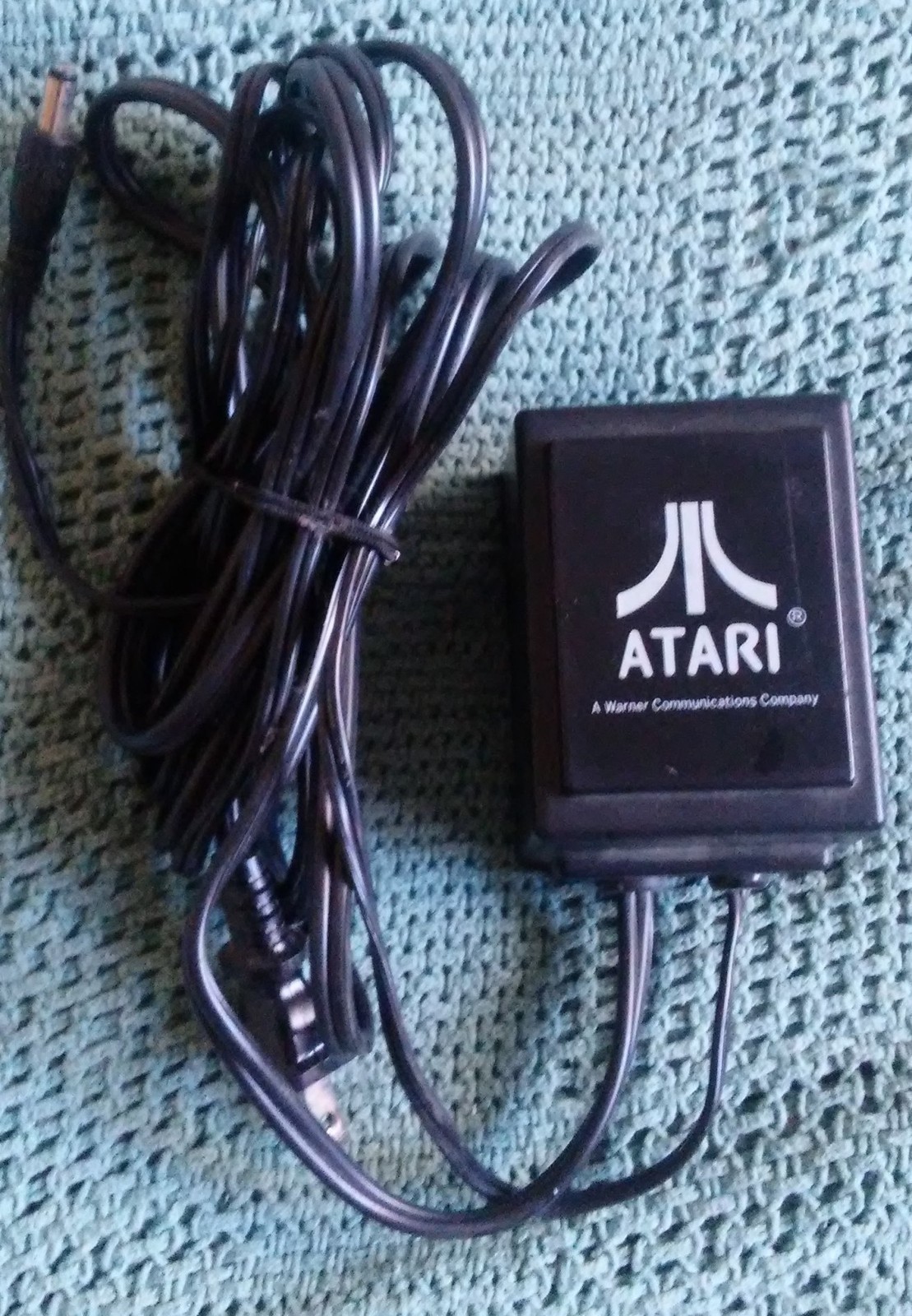

Sugarland Posted January 7, 2018 Share Posted January 7, 2018 Oh right my bad. Yes needs 9v AC with at least 2 amps. Still looking on amazon. Any suggestions please? Right now I'm using a '9 V AC 31 VA (3.4 A) Atari#CO17945' it's in good condition but I'd like to use a new PSU for safety and reliability concerns. Quote Link to comment Share on other sites More sharing options...
+DrVenkman Posted January 7, 2018 Share Posted January 7, 2018 Oh right my bad. Yes needs 9v AC with at least 2 amps. Still looking on amazon. Any suggestions please? Right now I'm using a '9 V AC 31 VA (3.4 A) Atari#CO17945' it's in good condition but I'd like to use a new PSU for safety and reliability concerns. Those are about as safe and reliable as anything you’ll find. I have about a dozen of those bricks for my 800’s, 400’s, 1200XL’s and 1050’s. They all put out rock solid voltage and work great, despite their age. “Newer” does not always equal “better.” 2 Quote Link to comment Share on other sites More sharing options...

ACML Posted January 7, 2018 Share Posted January 7, 2018 Hi. Would this power supply work for a 1200XL? Oh and please add mine to the list here are photos. 83S DA 52792 163 Seems so far to be working 100%. Will install a UAV-D asap. No. The 1200XL uses a 9V AC power supply. The one in your link is a DC power supply. You want an Atari CO17945 power supply. https://www.ebay.com/itm/Vtg-Genuine-Atari-Power-Adaptor-C017945-Supply-800-810-1050-disk-drive/253324376744?hash=item3afb4f3aa8:g:D90AAOSw4Z5aPGoI Quote Link to comment Share on other sites More sharing options...

Gunstar Posted January 7, 2018 Share Posted January 7, 2018 No. The 1200XL uses a 9V AC power supply. The one in your link is a DC power supply. You want an Atari CO17945 power supply. https://www.ebay.com/itm/Vtg-Genuine-Atari-Power-Adaptor-C017945-Supply-800-810-1050-disk-drive/253324376744?hash=item3afb4f3aa8:g:D90AAOSw4Z5aPGoI Here are a couple of those out of the shell, showing the only thing that goes wrong with them 99% of the time...needing replacement 125V 5A fuses. These are about to have them replaced and they will be as good as new! 1 Quote Link to comment Share on other sites More sharing options...

Sugarland Posted January 8, 2018 Share Posted January 8, 2018 Here are a couple of those out of the shell, showing the only thing that goes wrong with them 99% of the time...needing replacement 125V 5A fuses. These are about to have them replaced and they will be as good as new! Awesome thank you again for the replies. Per the advice here, I'll stay with the CO17945. Luckily I got a really nice condition one for free with an 800XL auction. He didn't even list it in the auction. He thought it was for the 800XL but he also included a proper 800XL PSU. The 17945 that came with the 1200XL is more used and the cord rubber feels as if it has dried or 'de gassed'. It's relieving to know that there is nothing within the 17945's that goes bad over time like capacitors, etc.. Well besides rust if there is any. A fuse is easily changed yeah! Cheers. Quote Link to comment Share on other sites More sharing options...
