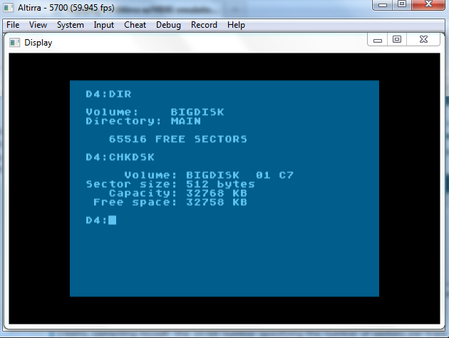

EDIT: Altirra does not seem to be able to correctly open 32 MB ATR files (65535 sectors, 512 bytes each, like the one I posted in the "ATR extension" thread). Since it is not very complicated (sectorsize = $200, all sectors of the same size), could you please consider adding that?
Also, it does not seem to like a 16 MB DD (256-bytes-per-sector) image. It's length is 16776336 bytes (65534 sectors * 256 bytes - (3 * 128) + 16), the header values are: $96 $02 $E0 $FF $00 $01 $0F ... (zeros). A800Win opens and accesses it w/o problem, on Altirra the SDX is not able to read/write this disk (error 139 occurs). Could you please verify, what's wrong?
