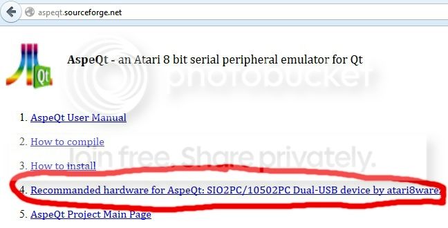

+wood_jl #17 Posted September 25, 2014 Very nice! I am glad to see this SIO2PC-in-a-plug made by a true professional, with a history of creating much-more complex devices, than this! I, too, am curious as to what software this will work with. The guy currently "supervising" someone's earlier work with Aspeqt has managed to remove support for Steve Tucker (Atarimax)'s features (specifically, APETIME), so that of course begs the question that of whether or not he'll sabotage future versions of Aspeqt to un-support competing devices. Once can only note that at the current time, the allegedly open-source (and thusly allegedly unbiased) Aspeqt only "recommends" ONE device, that sold by Ray Ataergin.......WHEN IT SHOULD recommend **ALL** such devices. Considering the source, no big surprise, however. http://i539.photobucket.com/albums/ff357/gbasp/Misc/AspeqtRecommededHardware_zps9b0ec726.jpg~original One would have thought that - the in the true nature of open source - that "recommended" hardware would be ANY/ALL SIO2PC devices, rather than that which one sells. One's expectations would be too high in that regard, evidently. Perhaps someone can link to the last version of Aspeqt that cyco130 (the REAL creator of Aspeqt) supported, in the hopes that it will be truly "open." It would be great to see the distribution "fork" into the true, continuing Aspeqt and away from the current botch. Meanwhile, Lotharek's version looks very good! The large connector is durable. 5 Quote Share this post Link to post Share on other sites

atari8warez #22 Posted September 27, 2014 Very nice! I am glad to see this SIO2PC-in-a-plug made by a true professional, with a history of creating much-more complex devices, than this! I, too, am curious as to what software this will work with. The guy currently "supervising" someone's earlier work with Aspeqt has managed to remove support for Steve Tucker (Atarimax)'s features (specifically, APETIME), so that of course begs the question that of whether or not he'll sabotage future versions of Aspeqt to un-support competing devices. Once can only note that at the current time, the allegedly open-source (and thusly allegedly unbiased) Aspeqt only "recommends" ONE device, that sold by Ray Ataergin.......WHEN IT SHOULD recommend **ALL** such devices. Considering the source, no big surprise, however. http://i539.photobucket.com/albums/ff357/gbasp/Misc/AspeqtRecommededHardware_zps9b0ec726.jpg~original One would have thought that - the in the true nature of open source - that "recommended" hardware would be ANY/ALL SIO2PC devices, rather than that which one sells. One's expectations would be too high in that regard, evidently. Perhaps someone can link to the last version of Aspeqt that cyco130 (the REAL creator of Aspeqt) supported, in the hopes that it will be truly "open." It would be great to see the distribution "fork" into the true, continuing Aspeqt and away from the current botch. Meanwhile, Lotharek's version looks very good! The large connector is durable. i am currently having too much fun to take this kind of crap seriously, quite frankly you should get out more and take some fresh air.. 2 Quote Share this post Link to post Share on other sites
