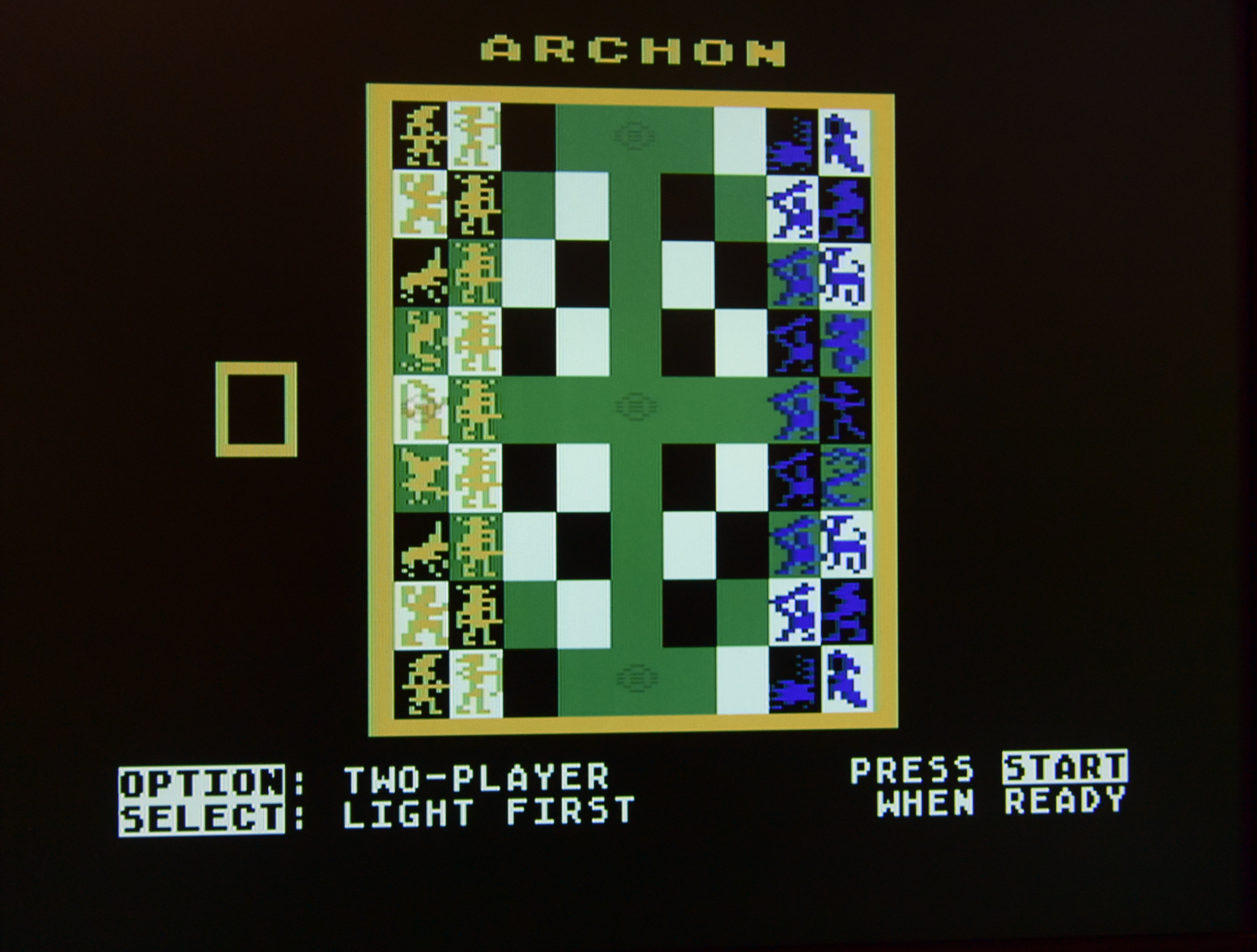

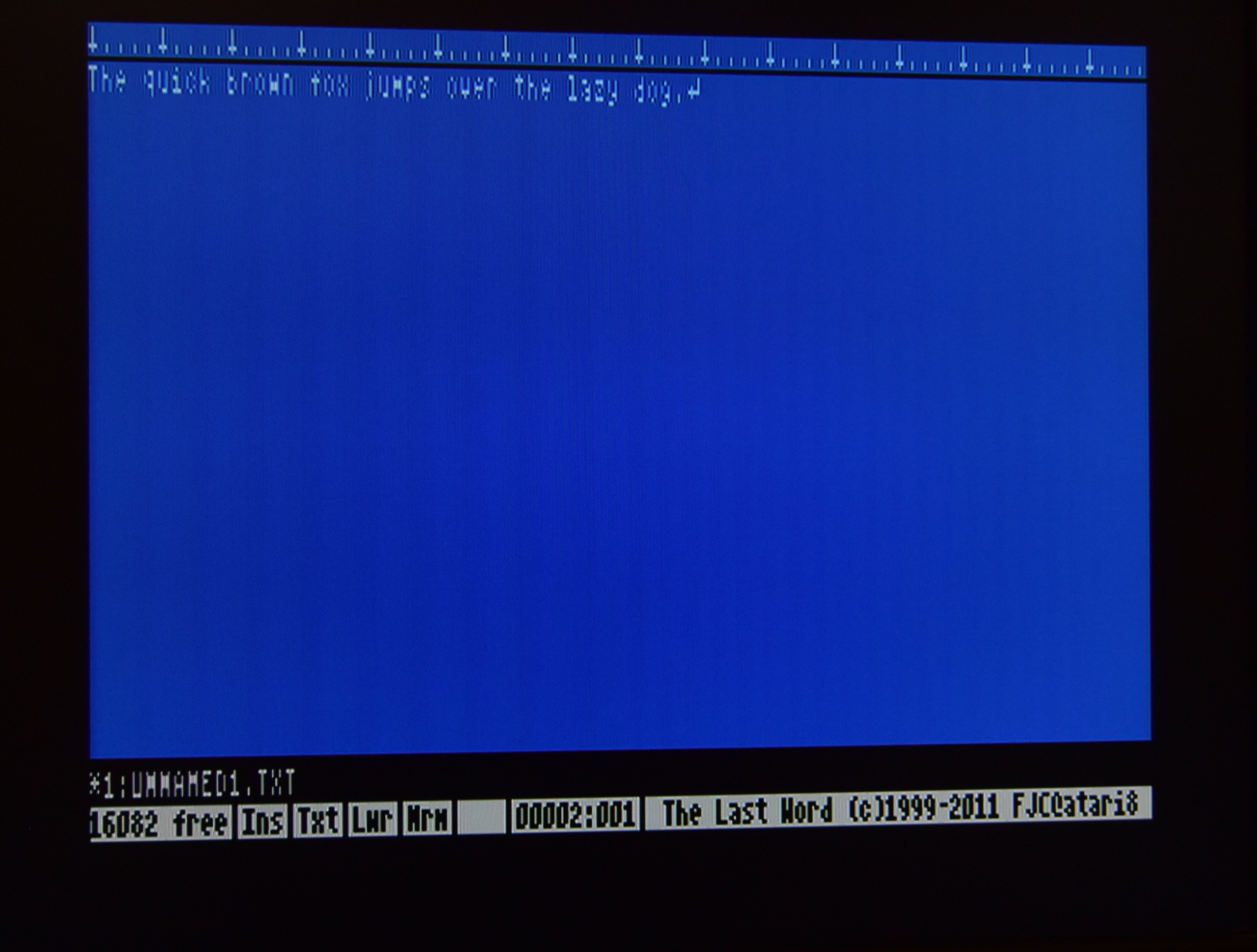

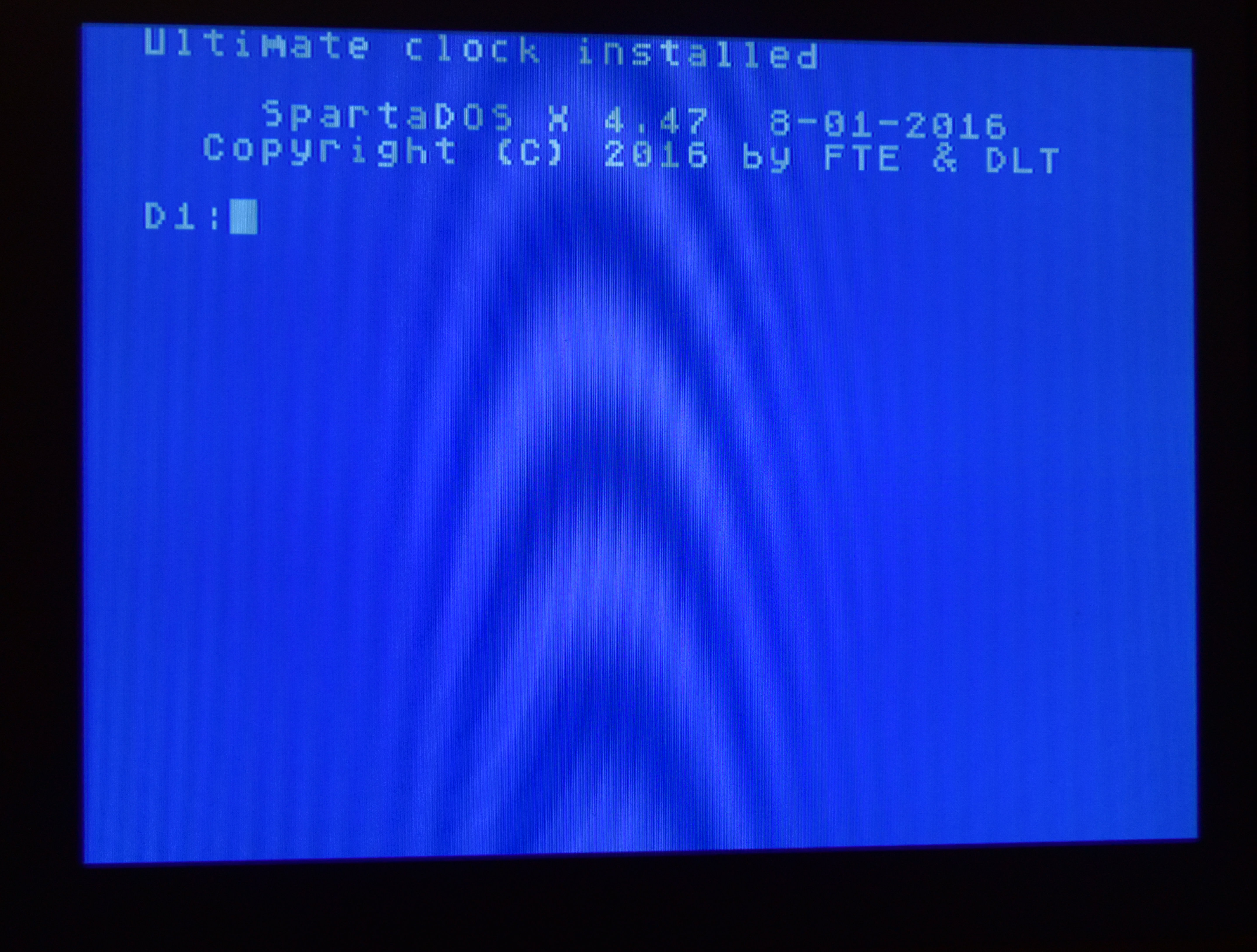

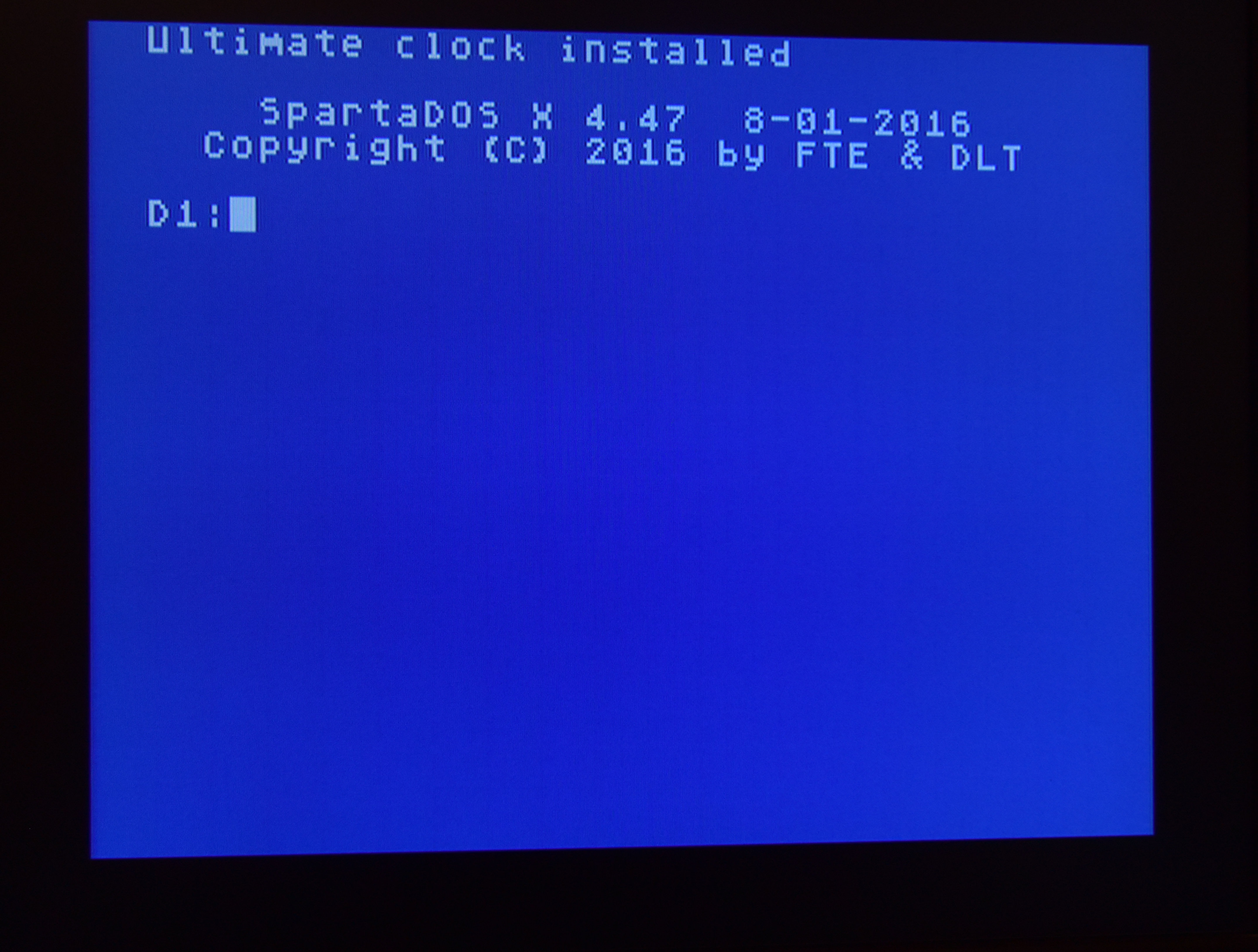

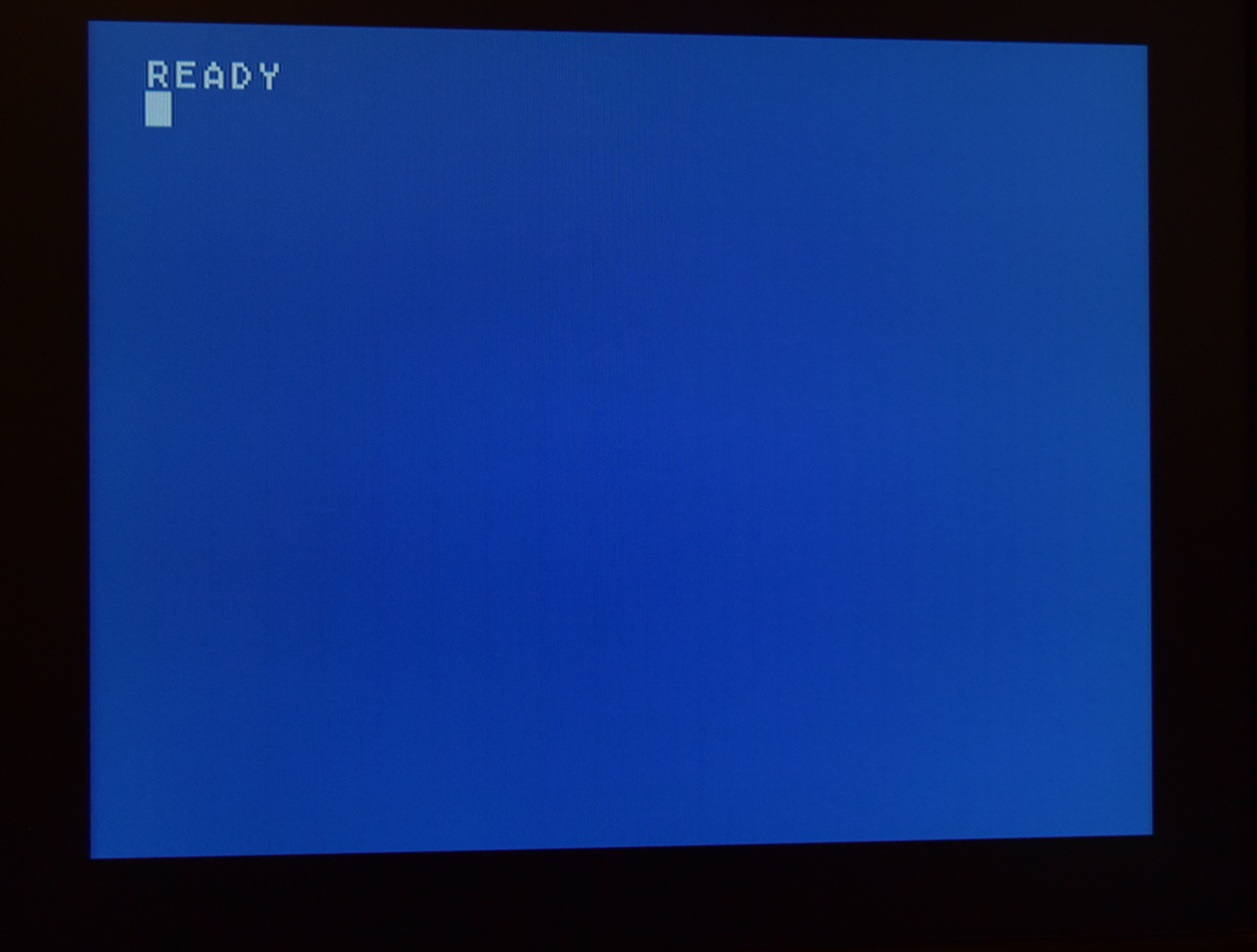

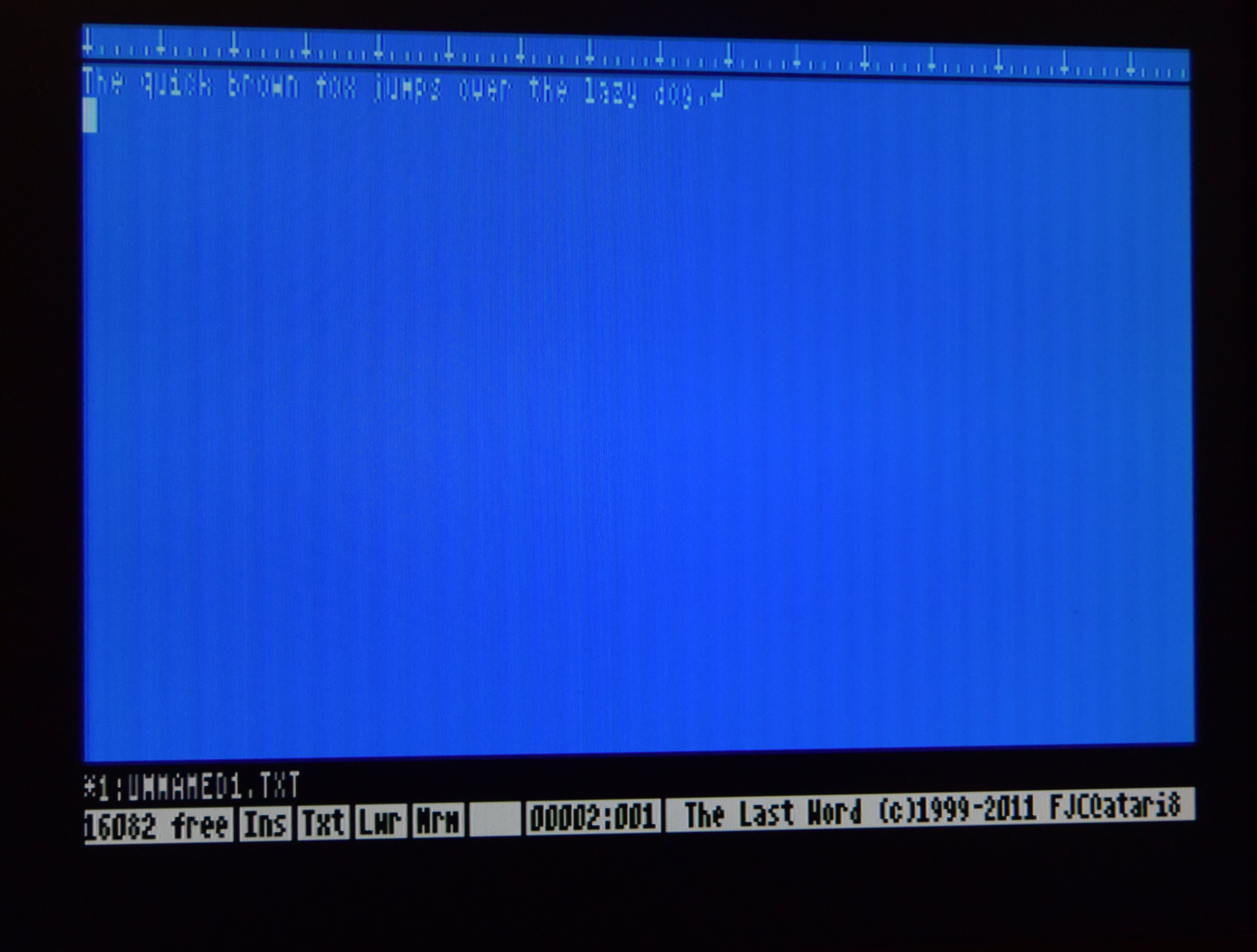

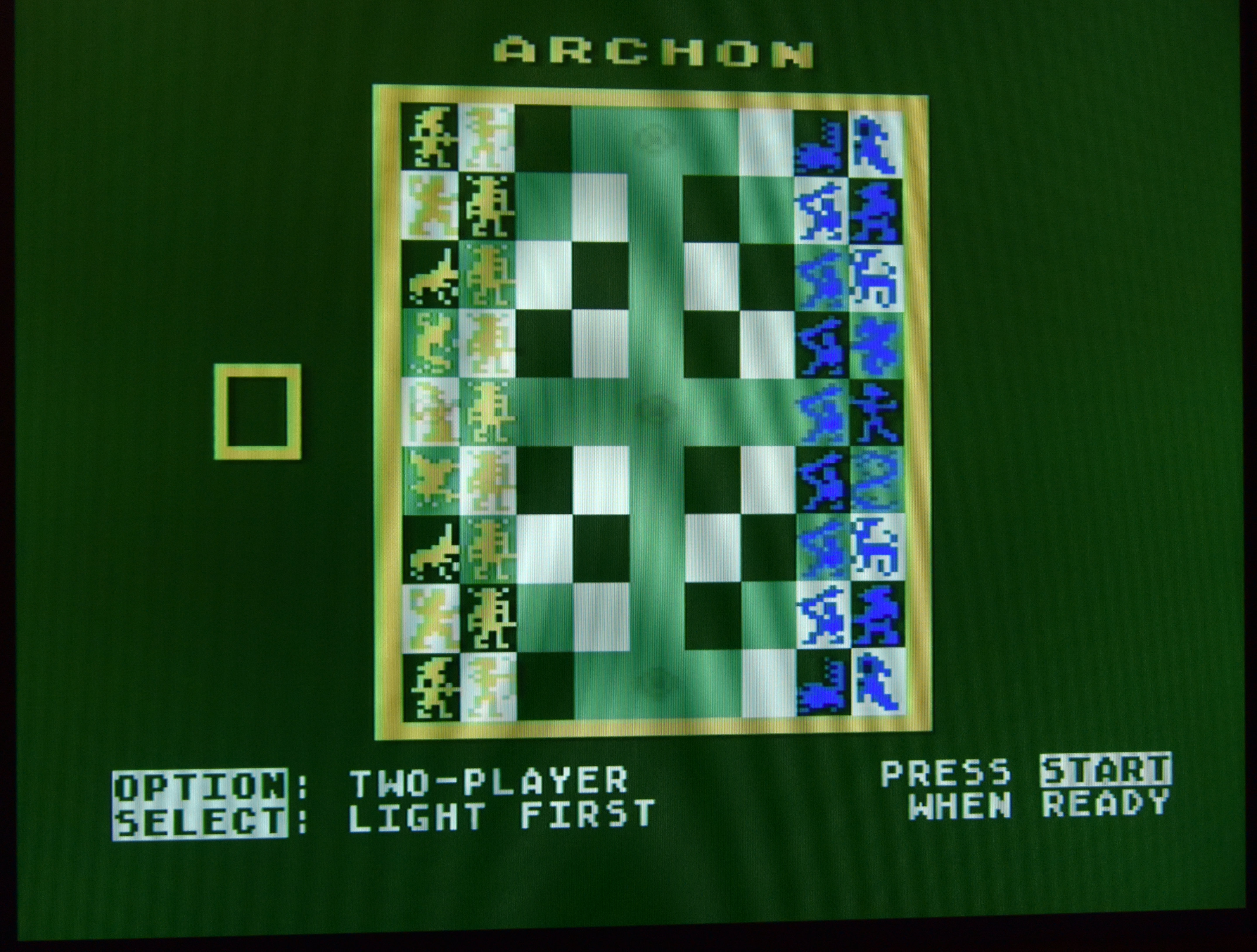

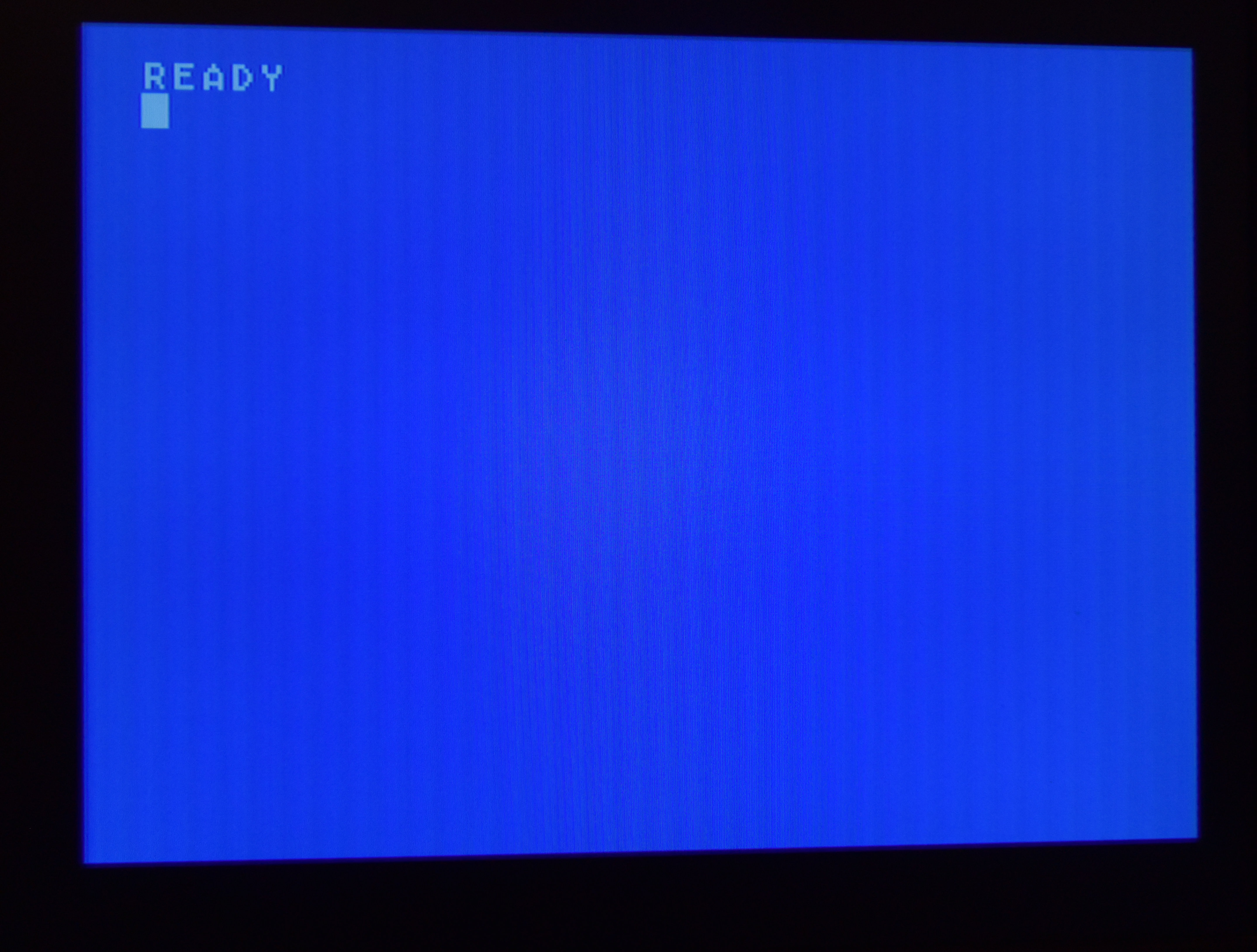

Panther #21 Posted March 29, 2016 I started working on this, but apparently my EtekCity converter has died. I can't get any output from it anymore. So, here are samples on a CheeseBox and the StarTech. Oh, I also couldn't seem to get the files to attach for some reason, so I stuck them on a remote server. Basic on CheeseBox: Basic on StarTech: SDX on CheeseBox: SDX on StarTech: LastWord on CheeseBox: LastWord on StarTech: Archon on CheeseBox: Archon on StarTech: 1 Quote Share this post Link to post Share on other sites

+mytek #24 Posted March 31, 2016 (edited) I started working on this, but apparently my EtekCity converter has died. I can't get any output from it anymore. So, here are samples on a CheeseBox and the StarTech. Oh, I also couldn't seem to get the files to attach for some reason, so I stuck them on a remote server. Thanks Panther The StarTech looks really nice Currently I have an EtekCity, which does a fair job, but obviously not perfect, and not as good as the StarTech. Tried the Portta, but that was a complete waste of money (didn't work well at all). The EtekCity has gotten to be more difficult to find. So I did a search and thought I'd try a unit being sold on Ebay for $40.60 with free shipping from China. I just received it yesterday (2 weeks after placing the order). It looks to be very well made, having a case made entirely out of metal. Testing will be conducted tomorrow. Ebay Listed as: Composite AV RCA / S-Video to HDMI Converter UHD 4K*2K UpScaler Adapter US P5K4 (I think they also have one with a euro AC adapter as well) Ebay Store: TomTop Shop (found it even cheaper here: LINK) I'll post some screenshots soon. - Michael Edited March 31, 2016 by mytekcontrols 1 Quote Share this post Link to post Share on other sites
