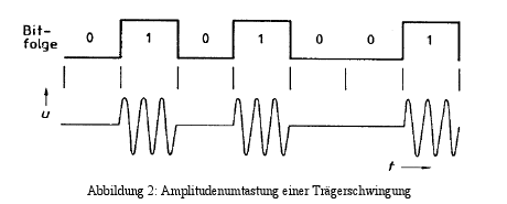

AlwaysOnPlanetPatrol #11 Posted June 16, 2016 (edited) We're talking about data transmission, not audio fidelity. You're sending 1s and 0s over an audio channel, similar as what we used to do in old modems over phone lines. You're not caring out getting that awesome pitch of a violin where you like to get those high sampling rates, you care about "hearing" enough about the flow of highs (1s) and lows (0s). So MP3s with a much smaller size would work just fine as a native wave file or OGG. I won't make comparison about analog audio from a tape versus digital MP3, before we know people are talking about gold connectors and stuff like that. I would just use MP3 because they would quicker to copy across devices and would work just as fine. Edited June 16, 2016 by AlwaysOnPlanetPatrol Quote Share this post Link to post Share on other sites

Dauber #15 Posted July 1, 2016 (edited) We're talking about data transmission, not audio fidelity. You're sending 1s and 0s over an audio channel, similar as what we used to do in old modems over phone lines. Still, it's data being converted into an audio signal, and the Starpath converting that audio back into data. And I just can't help but think that lossy audio compression could theoretically convert to a few missed bits here and there. If it doesn't great, but it's just the logical conclusion... Edited July 1, 2016 by Dauber Quote Share this post Link to post Share on other sites
Flojomojo #16 Posted July 1, 2016 Still, it's data being converted into an audio signal, and the Starpath converting that audio back into data. And I just can't help but think that lossy audio compression could theoretically convert to a few missed bits here and there. If it doesn't great, but it's just the logical conclusion... Nah, you're not going to miss anything by compressing this kind of signal. Music is like this. Binary is like this. If you compress the music signal, you're smoothing out the edges, trimming the highs and the lows, potentially losing dynamic range. If you compress the binary signal, you don't lose anything. There isn't any nuance lost, it's just ON and OFF, not peaks and valleys of varying size. These files are small enough that the raw .WAV files wouldn't be troublesome, but that format won't play on a pocket music player, hence the conversion to MP3. 1 Quote Share this post Link to post Share on other sites
AlwaysOnPlanetPatrol #17 Posted July 1, 2016 Nah, you're not going to miss anything by compressing this kind of signal. Music is like this. Binary is like this. If you compress the music signal, you're smoothing out the edges, trimming the highs and the lows, potentially losing dynamic range. If you compress the binary signal, you don't lose anything. There isn't any nuance lost, it's just ON and OFF, not peaks and valleys of varying size. These files are small enough that the raw .WAV files wouldn't be troublesome, but that format won't play on a pocket music player, hence the conversion to MP3. You're spot-on. MP3s are certainly much better quality than what the original tapes provided. Quote Share this post Link to post Share on other sites

+save2600 #19 Posted July 1, 2016 Pictorials and explanations above are rather crude and don't represent just what digital sampling is doing to an analog signal, let alone its resolution/word length/sampling rate. but agree about the type of signal in_this_case. Back in the early 2000's when I was using an mp3 player and a SuperCharger, had no problem loading the games. That was 14+ years ago. No need to further compress already compressed signals in 2016. Especially since storage constraints are no longer. And an mp3 player? You mean your phone or tablet? Quote Share this post Link to post Share on other sites
