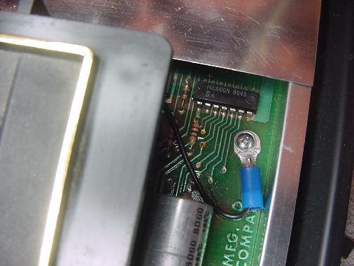

As far as the ground goes, wasn't there a motherboard screw right by the large capacitor:
S-Video%20Mod%20%5BClose-up%20of%20Groun
