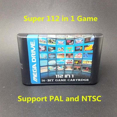

My Sega 112-1 cart that I purchased about a year ago will not play on my Retron 5. Works just fine on my Genesis but I want to use it on my Retron 5 so I can save games and play in high definition. I was thinking this must just be a problem with the Retron running Multi carts because of emulation but from reading on Amazon it appears others have had no trouble playing it on theirs. Do I need to possibly just update my software? I know there was a software update specifically for Genesis related issues with certain game compatibility and for compatibility with the powerbase converter.

  • This is the best new multi cart for the Genesis with 112 GAMES IN ALL!
  • Guaranteed to work in original hardware and high quality clone consoles only - RetroAD, MiniGen, Retron 3, Retro Trio all work. ATGames (Flashback), Retron 5, and Retro Freak will not work.

Retron 5 is basically an Android set top box that only lets you run a few emulators. If the Retron 5s emulators weren't made to understand the bankswitching in the mutlicart you're out of luck. Heck, if the Retron 5 cart dumping mechanism can't read the multi cart you're out of luck.

The R5 can be made to understand any multicart, but it would have to have a proper CRC value and cooresponding mapper setup included into it so it fires up. The Supervision 115in1 works on there but nothing else really. I was friendly with the coder a few years back when he worked on it and I had asked if it was possible, he told me he needed that. I ended up stuffing the cart into the system to get a CRC value, then tracked down the mapper information online and it was added in quietly. Normally it won't work, or it may try a default NES mapper setup (switches between 0-4) and you'll end up getting just the menu but no games play off of it. That's for NES though.
The other systems, they just won't work, unless someone can find a CRC value for it, and somehow hack it in there since they're no longer updating it. More work than it is worth. Easier buying the Sega AT Games HD system and hacking it, or the NES/SNES from Nintendo and throwing ROMs into that instead.

Thanks for heads up. Just ordered the 112 cart for $17 shipped from China. No rush, seller has 99.7% positive feedback and Ebay has great buyer protection anyways. I have a small collection of Genesis games and like the convenience of that 112 cart. Though no save capability, should work just fine in the 1st generation Genesis and AT Games Genesis Flashback.

Happy to report the 112 Genesis cart came in last week and works perfect! Under twenty bucks shipped, a nice collection of games!

No on my 1st generation Genesis. I mentioned that on the previous post, the cart compatible with Genesis and the ATgames PlugNPlay.
The Retron 5 designed for original carts ant not multi-game carts.

As I said awhile ago the R5 (and RetroFreak) are emulators and they look for what is there at face value. If you get lucky and it even boots, you'll only boot the multicart menu because it won't address the additional memory or CRC check for the game you wish to load so it's just not going to happen. Any crap quality or good quality(?) clone for the Sega or original Sega 1-3+nomad style system will run a game like that just fine I would imagine without any issue.
