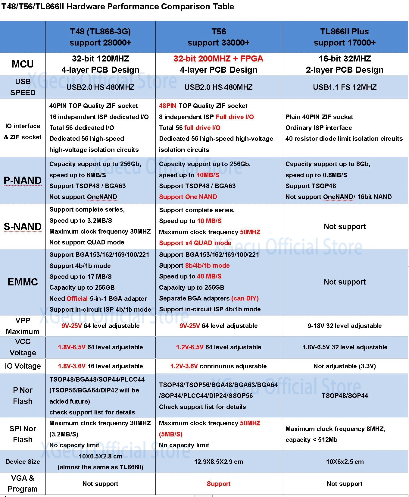

From time to time, someone posts a message lamenting the fact that there are few eprommers that support the old 25V chips that some of our TI gear uses. Most of the ancient chips were replaced by 21V versions in the early 1980's. Those, in turn have been replaced by the more recent 12.5V (or "A") versions. There are even 21V versions of the 2716. In a pinch, you can use a 2732 (same pin config) to replace them and simply program the first 2K. It seems that there are almost always "work-arounds" for most problems. The TL866CS/A will do 21V chips - the TL866II will not since it is limited to 18V max. The new T56 will do 25V chips.
The only nominal 25V chip in the mix is the TMS2532 (the "A" version is nominally a 21V chip) and even it can be programmed easily. TI - either by choice or chance - apparently used a single die to manufacture the TMS2532 and the TMS2532A. By extension, the Motorola MCM2532C, and the Hitachi (and other clones) which were licensed by TI and also used the same die are programmable at 21V. Some years ago, Tony Knerr discovered that both could be successfully programmed on the TL866CS at 21V using a simple adapter. The fact is, I have been able to program literally hundreds of them without fail using Tony's adapter and programming them as a TMS2732A.

I have a question about the T56...
  I'm guessing a typical USB can't supply the power to burn 25V EPROM's, but the T56 can, because it has provisions for adding a transformer?
  I asked one of the vendors on ebay, if they could point me to a transformer that would work, and I got back specs.
        Is anyone using a T56? Do you need the transformer to burn 25V devices? If you do, what's a good part number for the transformer?

Specifically which 25V chips are you trying to burn? The TL866CS will burn TMS2532s with an adapter. They appear to program at either 21V or 25V (along with the TI-authorized Motorola and Hitachi chips) as mentioned earlier in this thread. Most of the older 25V EPROMs have newer 21V versions.

Hi Atrax,
 I don't have a particular chip in mind, but figured having the transformer wouldn't be a bad idea, and just keep the extra juice plugged in?
