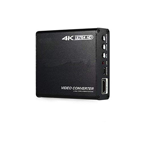

6BQ5 #29 Posted May 1, 2019 Digression : I tried this S-Video to HDMI converter from Amazon. https://www.amazon.com/gp/product/B00V2ULHBS/ref=ppx_yo_dt_b_asin_title_o02_s00?ie=UTF8&psc=1 If you are looking for an alternative to the Ambery unit then try this one. It works great! I am also using the same cable from 8-bit Classics. 1 Quote Share this post Link to post Share on other sites
chad5200 #30 Posted May 1, 2019 (edited) Digression : I tried this S-Video to HDMI converter from Amazon. https://www.amazon.com/gp/product/B00V2ULHBS/ref=ppx_yo_dt_b_asin_title_o02_s00?ie=UTF8&psc=1 If you are looking for an alternative to the Ambery unit then try this one. It works great! I am also using the same cable from 8-bit Classics. Thanks, I'll try that one. It's actually a lot cheaper than the one that Ambery is currently selling. Edited May 1, 2019 by chad5200 Quote Share this post Link to post Share on other sites
chad5200 #31 Posted May 3, 2019 Thanks 6BQ5! The Tendak you recommended from Amazon works great. Nice beautiful color. Warning: The AMBERY DVH3 has been discontinued. They replaced it with the DVH30. This new unit DOES NOT WORK on Atari 8-Bit Computers. 3 Quote Share this post Link to post Share on other sites

mellis #35 Posted May 7, 2019 Digression : I tried this S-Video to HDMI converter from Amazon. https://www.amazon.com/gp/product/B00V2ULHBS/ref=ppx_yo_dt_b_asin_title_o02_s00?ie=UTF8&psc=1 If you are looking for an alternative to the Ambery unit then try this one. It works great! I am also using the same cable from 8-bit Classics. I was in the market for a video scaler, and today I received and tested the unit mentioned above. Unfortunately, I cannot recommend it to those with a critical eye. This scaler generates visual artifacts galore. For example, areas that should be solid blue appear instead as a dithered checkerboard. That is but one of the glitches I identified, regardless of the settings I used with it. This is not to disparage the poster, I just want to save others the bother. Amazon has accepted my refund request. 1 Quote Share this post Link to post Share on other sites
6BQ5 #36 Posted May 7, 2019 I was in the market for a video scaler, and today I received and tested the unit mentioned above. Unfortunately, I cannot recommend it to those with a critical eye. This scaler generates visual artifacts galore. For example, areas that should be solid blue appear instead as a dithered checkerboard. That is but one of the glitches I identified, regardless of the settings I used with it. This is not to disparage the poster, I just want to save others the bother. Amazon has accepted my refund request. Oh, wow! That's really surprising. The image is super, super clean on my system. No checkered patterns, dithering, or noise. Just goes to show different everyone's system can be. I'm glad you were able to return it and get a refund. 1 Quote Share this post Link to post Share on other sites
