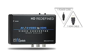

derFunkenstein #10 Posted July 12, 2018 yeah, if you're playing real hardware the OSSC or Framemeister are the only way to go. There are cheaper options that do okay, but systems that natively do 240p look kind of weird on those. I have this contraption and it does pretty well with my Saturn but I can't really recommend it for the non-interlaced content. I happen to be selling my OSSC and a SCART switch if you want to go that route. But it doesn't matter how you get into RGB, it's not for the faint of heart. Share this post Link to post Share on other sites
