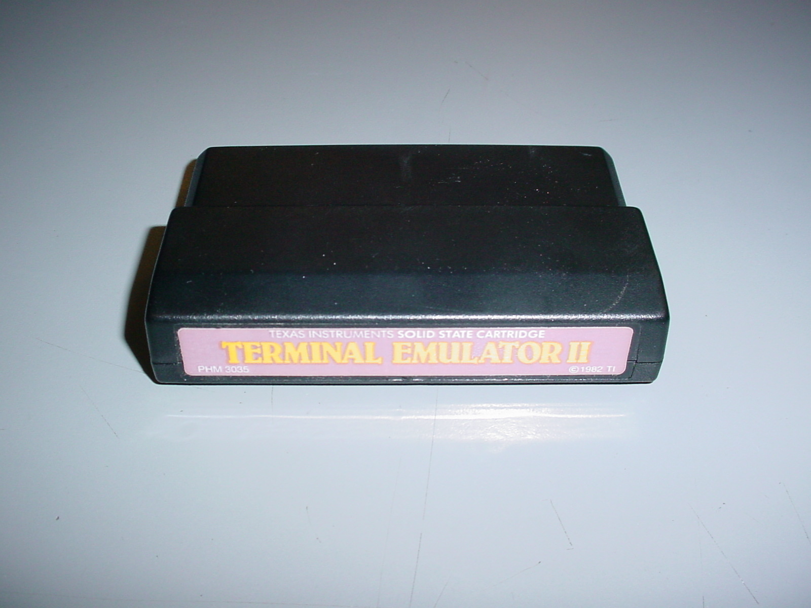

twoodland #1 Posted December 11, 2018 (edited) Does anyone have a .bin of Terminal Emulator II (TEII) (PGM3035) Basic? I would like to run it from my FinalGROM99 (FG99) cart. When I run the ones that I can find (TE-IIC.BIN, TE-IIG.BIN) they are like selecting option 2 and 3 from the TEII cartridge. Even if I do a warm boot and select option 1 Basic when the TEII options 2 and 3 are showing, the Basic does not have the speech functionality. Is there a trick or is there a separate TEII Basic .BIN available? Edited December 11, 2018 by twoodland Quote Share this post Link to post Share on other sites

Omega-TI #19 Posted December 13, 2018 One main reasons the Terminal Emulator II cartridge BIN is so hard to find is because it's not listed by name, but by it's TI catalog number of: PHM 3035. Hopefully by posting it here, in the future people will be able to easily find it with a search. Terminal Emulator II BIN.zip 1 Quote Share this post Link to post Share on other sites
