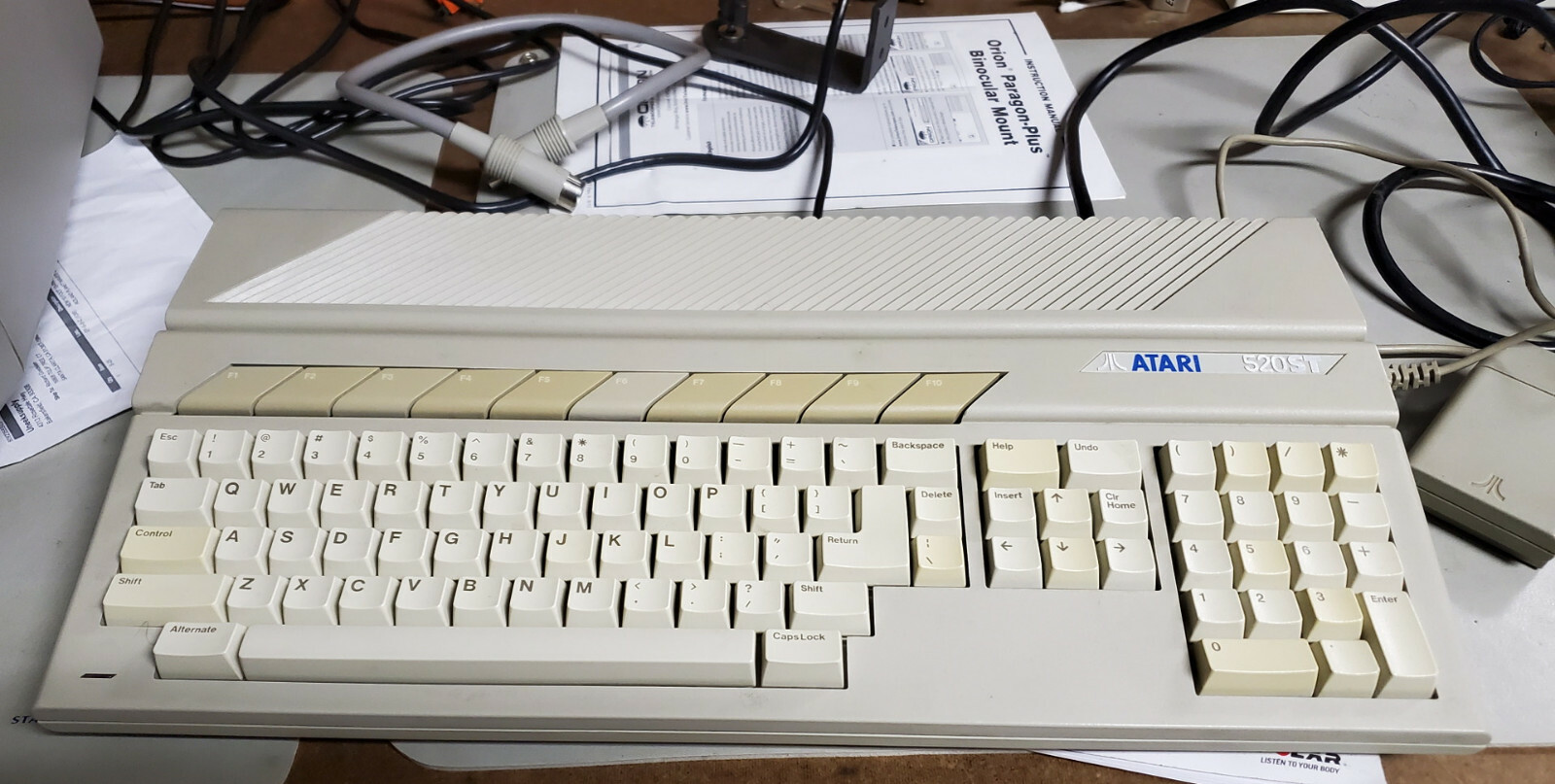

EdTorockio #1 Posted February 6, 2020 Hi Everyone. Introductions. I'm Ed from Pittsburgh, PA now in Raleigh, NC. I grew up in the 80's and 90's. First computer that was mine was an Atari 130XE. Sadly, after going to college, graduating, getting married yadda yadda... my parents decided to clean house in and it with my entire software collection, working printer, 1050, controllers, everything was donated to a GoodWill. Who know someone in this forum may be enjoying it to this day, I surely hope so. It had always been a dream of mine to own an ST however. My Dad and I used to go to the local WACO (Westmoreland Atari Computer Organization) that met once a month. One day around 1987 I saw demonstrated at the club an ST running GEM TOS and I was hooked. Had Macs, and PCs, and PowerPCs, etc... but always wanted to go back and get an ST Today it arrived. An Atari 520STM upgraded to 1 MB and some "video modifications" Only paid $60 for it so I figured would give it a try and if it doesnt work - could be a fun project to try to fix. I am good with a soldering iron, my other hobby is working on Nscale model trains - so yeah, small wire and parts I am good with soldering on. Here is the image from ebay: From Ebay: "This computer has been fitted with a memory expansion board, so it has 1 megabyte of RAM. It also has a modification to the video circuit, as shown in the pictures. I do not know what this does, but I suspect that it may convert the RF output from a modulated signal (requiring a TV with an NTSC tuner on channel 3 or 4) to a composite (unmodulated) video signal. I did not test this video output however, I only tested the RGB output as shown, which works. The mouse port also works, but I did not test any other external ports." Already ordered a 13pin din to VGA cable with 3.5mm sound which is on its way. I have an old 4:8 ratio LCD screen that has inputs for: VGA, S-video, Composite, 3.5mm sound, and Component. I have a lead on a 760k floppy external drive. My question to the group is - what else do you recommend - where do I go from here? Should I take the hood off and look inside, or wait for the accessories to arrive. Thanks Everyone! Ed 3 Quote Share this post Link to post Share on other sites

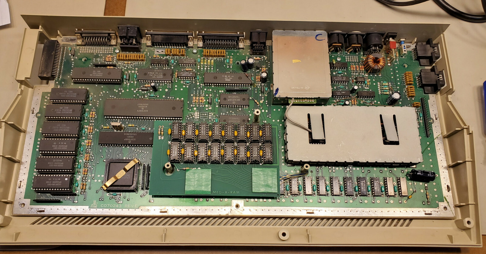

EdTorockio #2 Posted February 6, 2020 Here is the image of the inside that was posted on ebay: Quote Share this post Link to post Share on other sites

ParanoidLittleMan #5 Posted February 6, 2020 That talk about " convert the RF output from a modulated signal (requiring a TV with an NTSC tuner on channel 3 or 4) to a composite (unmodulated) video signal " (sorry for size, really does not deserve more 🙂 ) is typical for sellers - complete rubbish - while could look for what outputs are on STs. If there is RF, then there is composite output too (look ST video connector pins and functions). And converting from RF to composite would be low quality at high price. Only once I saw composite to RGB converter in one C64 - which has no RGB out - was from France, and since was no Secam C64 manufactured it was necessary for those (I guess minority) which TV was not multi norm, so were no colors with PAL (Eu market) C64 . Basically, they added to C64 circuit what is normally in PAL TV-s . Really can not say about that mod - only 1 wire to modulator is visible on photos. Quote Share this post Link to post Share on other sites

English Invader #17 Posted March 9, 2020 On 3/2/2020 at 8:27 PM, EdTorockio said: Noticing some weird things, I probably need to read more online but not yet sure where to get the info. First, when I hooked up my Ultrasatan and popped in the SD card that came with it, it looks like it was partitioned into several drives. When I open up the games folder, none of the individual games listes (which included old favs like 1943) had any actual files in them. Second, the ST recognizes the UMS floppy, sees there are files, but wont run them. Your ST only has 1MB of RAM and the TOS ROM is likely either 1.00 or 1.02 which is insufficient for running a hard drive and, if memory serves, the driver that Lotharek provides is unable to run commercial software. You need the PP driver for that and it's up to you to format and partition the SD card. If I had seen this thread sooner, I would have recommended a Gotek floppy emulator rather than a hard drive emulator because it's more suited to the specs of your system but you should still get some decent use out of the US if you upgrade the memory to 4MB and replace the TOS with 1.04. Quote Share this post Link to post Share on other sites
ParanoidLittleMan #18 Posted March 9, 2020 6 hours ago, English Invader said: Your ST only has 1MB of RAM and the TOS ROM is likely either 1.00 or 1.02 which is insufficient for running a hard drive and, if memory serves, the driver that Lotharek provides is unable to run commercial software. You need the PP driver for that and it's up to you to format and partition the SD card. If I had seen this thread sooner, I would have recommended a Gotek floppy emulator rather than a hard drive emulator because it's more suited to the specs of your system but you should still get some decent use out of the US if you upgrade the memory to 4MB and replace the TOS with 1.04. OMG ! So much incorrect claims in just one reply. TOS 1.00 and 1.02 can work with hard drives. Only that max partition size is limited to 256 MB. And less reliable, little slower, but not that bad. Plenty of people using 1.02 or 1.00 (much more first of 2), and can run commercial SW. Actually, this is first time I see this claim about that because driver commercial SW will not work 🙂 My hard disk adaptations were tested with diverse TOS versions, and all it works under TOS 1.02, and most likely 1.00, although I did not test with it. No need, really. Most likely it is my driver, demo version what is in question here, since I made game compilation on Lotharek's request. He used ICD driver before, and sends some other compilation too now, with demos and games, probably with ICD. What I composed is on 6 partitions, right because older TOS versions, so on 6x 255 MB partitions. It is not hard drive emulator. UltraSatan is real hard disk in fact, and SD cards are even harder than some classic hard disk 🙂 Not to mention that much more solid . OK, latest sentence is good advice: upgrading memory, and TOS to 1.04 (preferable 1.04i 🙂 ) is useful. Hard disk versions of SW (games mostly) will need more RAM than when run from floppy or Gotek - so 1 MB games need 2 MB RAM usually. Since this has already 1 MB RAM, about 90% of hard disk adapted games will work - well, when all is OK. Hard disk versions offer more than floppy versions, cracks: possible to exit to Desktop, to position where started game, to save game states any moment. No need for swapping disks or images on some HW floppy emulator like Gotek or HxC . And of course much faster load, start. 2 Quote Share this post Link to post Share on other sites

EdTorockio #23 Posted April 7, 2020 On 3/9/2020 at 3:59 AM, ParanoidLittleMan said: OMG ! So much incorrect claims in just one reply. TOS 1.00 and 1.02 can work with hard drives. Only that max partition size is limited to 256 MB. And less reliable, little slower, but not that bad. Plenty of people using 1.02 or 1.00 (much more first of 2), and can run commercial SW. Actually, this is first time I see this claim about that because driver commercial SW will not work 🙂 My hard disk adaptations were tested with diverse TOS versions, and all it works under TOS 1.02, and most likely 1.00, although I did not test with it. No need, really. Most likely it is my driver, demo version what is in question here, since I made game compilation on Lotharek's request. He used ICD driver before, and sends some other compilation too now, with demos and games, probably with ICD. What I composed is on 6 partitions, right because older TOS versions, so on 6x 255 MB partitions. It is not hard drive emulator. UltraSatan is real hard disk in fact, and SD cards are even harder than some classic hard disk 🙂 Not to mention that much more solid . OK, latest sentence is good advice: upgrading memory, and TOS to 1.04 (preferable 1.04i 🙂 ) is useful. Hard disk versions of SW (games mostly) will need more RAM than when run from floppy or Gotek - so 1 MB games need 2 MB RAM usually. Since this has already 1 MB RAM, about 90% of hard disk adapted games will work - well, when all is OK. Hard disk versions offer more than floppy versions, cracks: possible to exit to Desktop, to position where started game, to save game states any moment. No need for swapping disks or images on some HW floppy emulator like Gotek or HxC . And of course much faster load, start. Thanks! Had to put off working on the Atari for a little bit. Ordered 1.04 online and should be here this weekend. Also picked up a Mega 2. Will see how this works with the TOS update. The nice thing about the Mega is it has a blitter, and a 1.44 HD floppy. Quote Share this post Link to post Share on other sites
