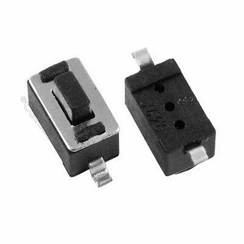

As you can see in the pictures below, you have to make some cut lines on
the pcb traces to acomidate for the width of the switches. It's not that hard
just don't cut yourself! First remove the clear plastic strip covering the pcb
and the dome contacts. Clean off any extra adhesive left on the pcb. If you don't
getting all don't worry it's not the end of the world.
After making these 5 cuts to the U,D,L,R and Fire contacts (red is cut line, blue is new
bridged conntection in photo) you will have to bridge the orphaned side of the cut to the other
side of the connection needed for each direction and fire. Again, it's not super hard to do just be
true and confident when soldering. You can use any small piece of wire to do this. I suggest a solid
core strand but even braided will work. Just be sure it's of less height than the contact itself and you might
want to tin it with solder first.
 After making these new connections and before closing up the joystick you will need to cut
1/8th of an inch off the contact points of the internal white plastic joystick actuator that goes
inside the CX40 boot. Again, not a big deal, just don't cut too much and don't cut yourself! Remove
the spring from the fire button as you won't need it. On the fire button orange cap you only need
to remove about 1/16th off the center contact pole. You can also solder the clasps on the wires
for a more secure connection if you choose to, not needed but worth the extra minute of your time
to do so. I've had joysticks in the past where one has come loose over time. This makes sure
that can't happen.

8 minutes ago, Lost Monkey said:
Nice! Got a part # for the switches?
No, but I do have a link to get 50 of them for $1.68 shipped from China :)
These are not the exact ones I used but they are the same dimensions and
should do the job.
should do the job.
https://www.ebay.com/itm/50Pcs-Momentary-Tact-Tactile-Push-Button-Switch-Smd-Smt-Surface-Mount-3-6-5MM-mm/254387062359?hash=item3b3aa68657:g:~igAAOSw99RdofES
sorry to question you Shawn, but those are 5mm tall, did you mean this at 3x6x2.5?
https://www.ebay.com/itm/20Pcs-3X6X2-5mm-Tactile-Push-Button-Switch-Tact-Switch-Micro-Switch-2-Pin-SMD-GM/262136738936?hash=item3d08913478:g:UiQAAOSwgqZdqZS1
  • Like 1
Share this post
Link to post
Share on other sites
8 hours ago, bah said:
Those are the exact ones I used, I couldn't find them when Monkey asked. The 5mm ones will work too you would just need to clip another 2.5mm off the joystick contact shaft or a little off the top of the plastic actuator button on the switch.

Just out of curiosity, why not just turn some of those switches 90 degrees so you wouldn't have to cut so many traces? As long as the center of the button is over the center of the actual contact trace and not the ground it should work the same?
Share this post
Link to post
More surface area makes contact with the plunger when placed as I have them.
