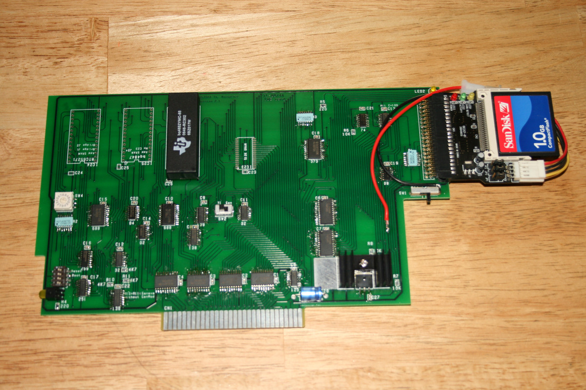

Swim Posted March 28, 2020 Share Posted March 28, 2020 This is a pic of the IDE controller with compact flash that has been running 24/7 for almost a decade in the Hidden Reef BBS P-Box and holds the up/down load files. 5 1 Quote Link to comment Share on other sites More sharing options...

Swim Posted March 29, 2020 Share Posted March 29, 2020 There are a few design problems with this controller card like many designs problems don't exist until the design makes it out into actual use. The 10K resistor location next to the heat sink at the bottom right corner needs to be placed away from the back edge of the card as it often gets knocked off when the card is inserted into the P-Box. I can't tell you how many of those I replaced for TIers that often swap cards in and out. Quote Link to comment Share on other sites More sharing options...
