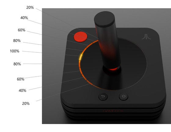

Don't know, stopped following it a long time ago
https://atarivcs.com/
but it would be really cool
https://medium.com/@atarivcs/peripherals-update-designed-for-atari-vcs-in-partnership-with-powera-252685b0f2f1
can someone call them and tell them to make sure it works with the 8bitdo on the original vcs :)
nomnomnom

Oh! I've forgotten that that the "Atari VCS" even exists. Maybe because it doesn't. :P
