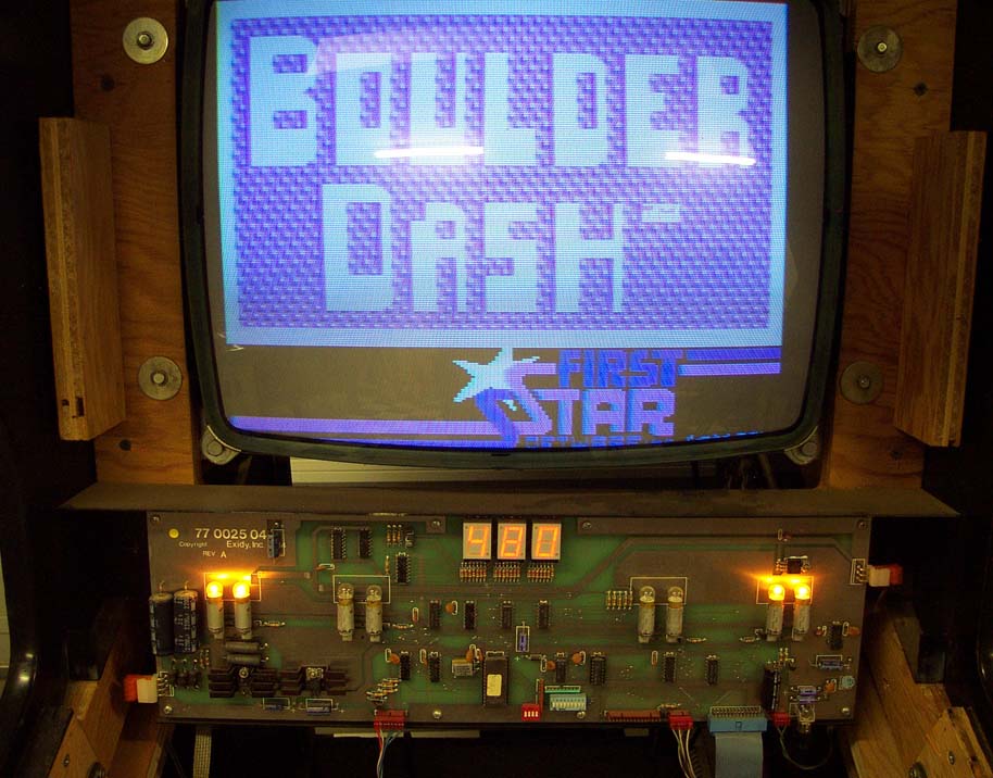

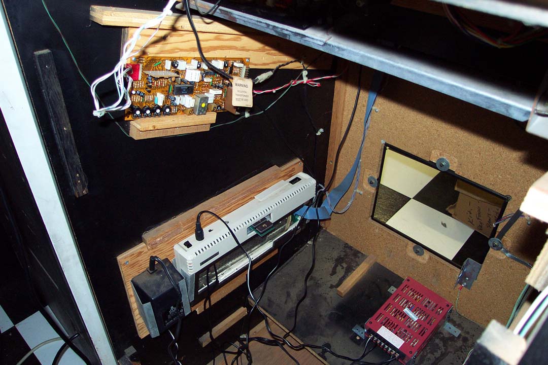

djpubba #24 Posted February 4, 2009 (edited) You can get composite video from a 600XL by just soldering a cable to the correct spot inside without any other modding. I don't have the details though. I only know it's possible because I got one that it was done to. http://www.arcadecollecting.com/boulder/inside.jpg They actually convert the composite signal to RGB to display on an arcade monitor on that one. Looks pretty good considering! http://www.arcadecollecting.com/boulder/controller.jpg Edited February 4, 2009 by djpubba Quote Share this post Link to post Share on other sites
