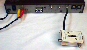

The following instructions are relevant to most vintage videogame and computer systems that connect to a television. Specifically, the Atari 2600, 5200, and 7800. However, if you have the 4-port (four joystick ports) version of the 5200, you need a special switchbox. Try eBay or Best Electronics (catalog item) for this proprietary switchbox. If you have the 2-port version of the 5200, you can use the methods described below.
Coaxial
Composite
Speaking of demodulators, you can simply use one of these instead of taking up all that space with a VCR. Unfortunately, these are much more expensive ($100+) and you're not likely to find one in a thrift. Unless you're going to make a hardware modication, we really recommend using a straight coaxial connection, because going through a VCR/demodulator defeats the purpose of a composite connection. |
