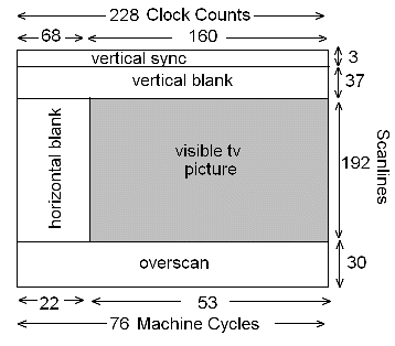

Let me do my own version of that Stella Programmer's Guide diagram:
Here's what's going on. First, the CPU has to send the VSYNC. This message gets to the TV and tells it to get ready to start a new "frame", or picture. But you can't just hit it and quit it...the CPU has to wait for 3 whole scanlines for the Television to get the message. Luckily, waiting for a scanline to finish drawing is one of the things the Atari does best...you'll learn that when you "do a WSYNC", the CPU halts, and waits for the current scan line to finish. So an Atari Program turns on the VSYNC, does WSYNCs three times, the turns the VSYNC off. Now the TV's good to go.
Now the Atari enters the time known as the "Vertical Blank". The TV hasn't really begun to draw the picture yet...it won't for another 37 scanlines. In fact, the CPU needs to turn on a special "VBLANK" register that says there's no picture here. In general, there are two strategies for this time. The most obvious strategy is to just do another 37 WSYNCs. A better strategy (we'll learn the details of this in a bit) is to set one of the Atari's timers. That way we can do alot of the game logic we want (move things, check collisions, fiddle with memory, all the jazz) without having to know if a series of instructions fits in a particular scanline or not. We set a calculated amount into a timer, then once our program logic is done logic'ing, we do a "do-nothing" loop until the timer equals zero. Then we turn off VBLANK. And then we move on.
Time to start drawing...almost. For each line, you get about 22 Machine Cycles of "Horizontal Blank" to do some work...usually spent telling the TIA if the various players and missiles and playfields (oy, you'll find out them in a bit) are "on" for the upcoming line and then the electron starts drawing. Now, the Stella Programmer's Guide talks about how you can get extra time to do game calculations by only setting TIA every other line...and programmers who are really slick can do all sorts of logic on the fly, have everything ready to go for the TIA just in time, and still be home in time for dinner.

Once you've done the 192 lines (or so...sometimes the math gets a little crooked) you get another respite, the "oversan" period. This is just like the vertical blank, except its only 30 lines, not 37. So you should set the VBLANK it might make sense to do the timer trick again, and do some more program logic.
Once the overscan is finished, it's time to start over with the VSYNC. (Note that if you've turn on VBLANK at the start of the the overscan, you might as well leave it on throughout the vertical sync, since the vertical blank period needs it to.)

Oh, and the diagram above is a bit of a lie...really, there's some "horizontal blank" time on either side of the visible image, the part you can see isn't really on the right side like that. But in practice, the view in the illustration is good enough.
