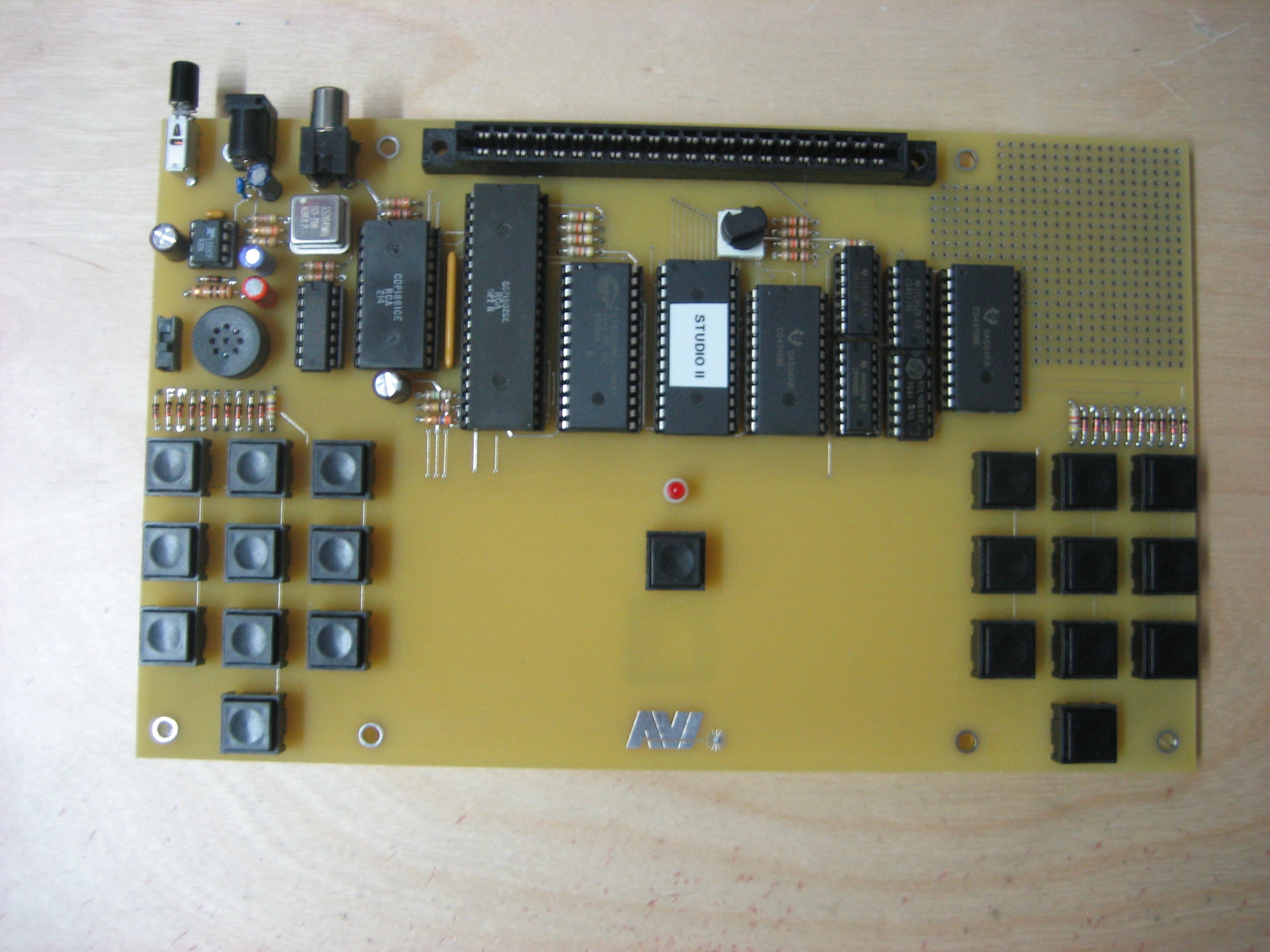

+kevtris #265 Posted April 11, 2013 I've got a rebuild of this on my desk as I write. It is a standard 555 astable circuit with the upper resistor 400k (2 x 200k in mine) and the lower resistor 480k (470k in mine). I measured these (I think) so they probably are 390k and 470k resistors as 400/480 are not standard sizes. The capacitor is 2.2nf. I don't know if there's a speaker driver on the output, this circuit is sufficient to drive a Piezo Buzzer. Thanks for that information! You guessed right on the resistors, going by the schematic that was just posted. Hello, I would like to share some information I have on the RCA Studio II. I had a non-working unit so I decided to remove all the components from the PCB and scan both sides. From this I drew up a schematic of the board. I then used an ohm meter to verify my drawing. I redesigned the circuit and built my own Studio II. It is sort of a multi-cart version. I have a little 16-position rotary switch that selects which "Cart" to run. It is limited to 1K cartridges however. It has 32K of ROM and 32K of RAM. I did this only because I use these chips quite often and have a bunch of them. My board does not have an RF section, only a video out. A+ job on recreating the S2! I am going to do this for the Video Brain and the Arcadia 2001 since both are quite rare and expensive, not to mention cartridge availability issues. As to the S2, I was curious on a few of the details of how the chips were connected. I did a few minor modifications to put my FPGA in line with the actual circuit. Thanks for posting the schematics. it was helpful. Quote Share this post Link to post Share on other sites
