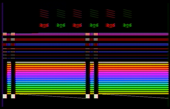

Actual video capture of Glenn's demo running on an Atari 2600 (thanks to Glenn Saunders):
Screen capture taken in z26 (thanks to John Saeger):
