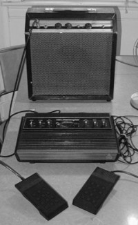

The Synthcart is a rather unique cartridge that allows you to play music on the Atari 2600 using a pair of keyboard controllers. Each keyboard controller controls one of the two oscillators in the Atari 2600. Some features of the Synthcart include:
  • Play using an assortment of familiar Atari sounds
  • Use two different sound types at a time, one assigned to each controller
  • Intelligent voice management constantly reassigns the two oscillators for maximum perceived polyphony
  • 8th, 16th, and 32nd note arpeggiator
  • Can arpeggiate both oscillators simultaneously
  • Beat Box with many preprogrammed beats and fills
  • Play two beats simultaneously to create custom beats
  • Two tremelo settings
  • Four attack/release settings
  • User interface designed so that you can program and play the synth without a TV. Modify your Atari with an audio out, and you just need your Atari and an amp.
